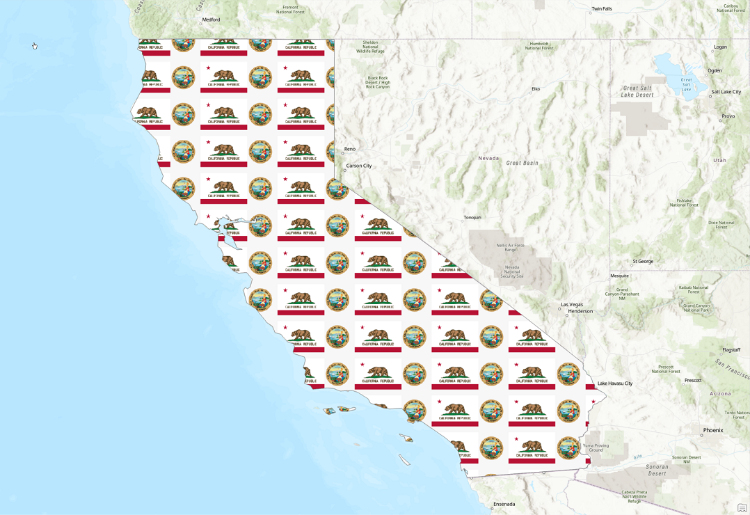

    Example
    Picture fill
    /// <summary>
    /// Constructs a picture fill with the specified parameters.
    /// ![ConstructPictureFill](https://ArcGIS.github.io/arcgis-pro-sdk/images/Symbology/ConstructPictureFill.png)
    /// </summary>
      //Note: Run withing QueuedTask
      CIMStroke outline = SymbolFactory.Instance.ConstructStroke(CIMColor.CreateRGBColor(110, 110, 110), 2.0, SimpleLineStyle.Solid);
      //picture
      var imgPath = Path.Combine(Path.GetDirectoryName(Assembly.GetExecutingAssembly().Location), @"Images\CaliforniaEmblem.png");
      var pictureFill = SymbolFactory.Instance.ConstructPictureFill(imgPath, 64);
      List<CIMSymbolLayer> symbolLayers = new()
        outline,
        pictureFill
      CIMPolygonSymbol pictureFillPolygonSymbol = new CIMPolygonSymbol() { SymbolLayers = symbolLayers.ToArray() };
      //To apply the symbol to a polygon feature layer
      //var renderer = theLayer.GetRenderer() as CIMSimpleRenderer;
      //renderer.Symbol = pictureFillPolygonSymbol.MakeSymbolReference();
      //theLayer.SetRenderer(renderer);
