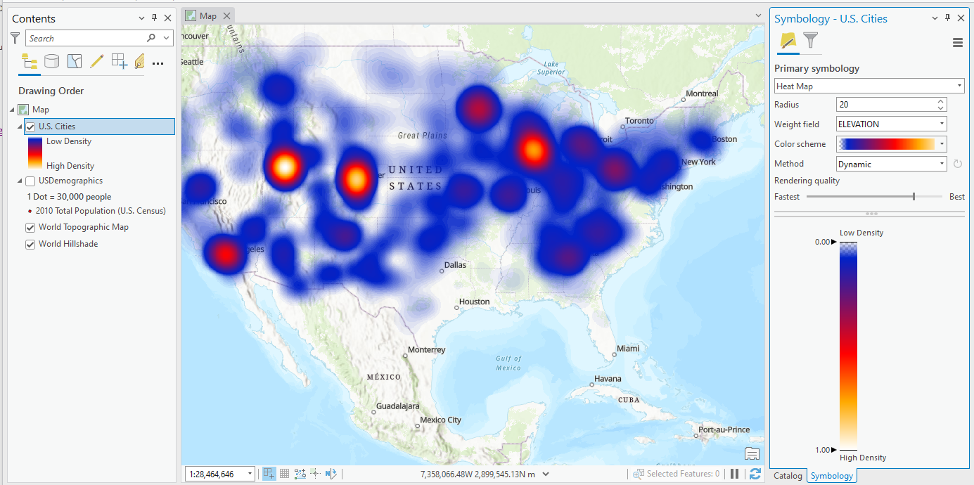

    Heat map renderer
    /// <summary>
    /// Renders a point feature layer using a continuous color gradient to represent density of points.
    /// ![Heat map renderer](https://ArcGIS.github.io/arcgis-pro-sdk/images/Renderers/heat-map.png)

      //Check feature layer name
      //Code works with the U.S. Cities feature layer available with the ArcGIS Pro SDK Sample data
      var featureLayer = MapView.Active.Map.GetLayersAsFlattenedList().OfType<FeatureLayer>().FirstOrDefault(f => f.Name == "U.S. Cities");
      if (featureLayer == null)
        MessageBox.Show("This renderer works with the U.S. Cities feature layer available with the ArcGIS Pro SDK Sample data", "Data missing");
      //defining a heatmap renderer that uses values from Population field as the weights
      HeatMapRendererDefinition heatMapDef = new HeatMapRendererDefinition()
        Radius = 20,
        WeightField = "NumericField",
        ColorRamp = colorRamp,
        RendereringQuality = 8,
        UpperLabel = "High Density",
        LowerLabel = "Low Density"
      //Note: Run within QueuedTask
      CIMHeatMapRenderer heatMapRndr = (CIMHeatMapRenderer)featureLayer.CreateRenderer(heatMapDef);
      featureLayer.SetRenderer(heatMapRndr);
