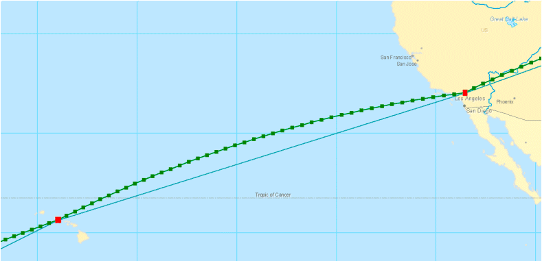

    The image below shows the results of applying the GeodeticDensify method to a polyline with curveType = Geodesic. The densified polyline represents a flight path between stops in Honolulu and Los Angeles. The original polyline is modified by adding additional segments that identify the shortest ground distance between these locations.
    GeometryEngine Geodesic Densify
