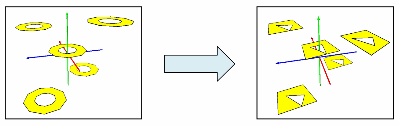

    Remarks
    Generalize3D performs a Douglas-Peucker Generalization algorithm, extended to operate in 3D space, with a specified maximum offset tolerance, given in 3D, as input. For line segments, the generalized output is a subset of the original input vertices. For non-linear segments, the generalized output contains points along all parts of the curve, not necessarily only the vertices.
    GeometryEngine Generalize3D
