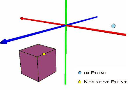

    Finds the nearest point, in 3D space, on a Z-Aware geometry to a specified point.

    If the input geometry is a non-empty point, then ProximityResult.PointIndex = 0, ProximityResult.PartIndex = 0, and ProximityResult.SegmentIndex is null.
    If the input geometry is a non-empty multipoint, ProximityResult.PointIndex is the index of the nearest point in the Multipoint, ProximityResult.PartIndex = ProximityResult.PointIndex, and ProximityResult.SegmentIndex is null.
    Otherwise, if the input geometry is non-empty, then ProximityResult.PointIndex is null and ProximityResult.SegmentIndex is the segment which contains the nearest point. The segment index is relative to the ProximityResult.PartIndex. For example, if the segment index = 0 and the part index = 2, then the segment containing the nearest point is segment 0 of part 2. In other words, the segment is the first segment of the third part.
    Proximity.RightSide is irrelevant for 3D operations and is always set to false.
    If either of the input geometries are empty, then ProximityResult.Distance = -1, ProximityResult.Point is empty, ProximityResult.PartIndex = -1, ProximityResult.PointIndex is null, and ProximityResult.SegmentIndex null.

    The nearest point does not have to be a vertex of the input geometry. It can be any point contained in the geometry.
