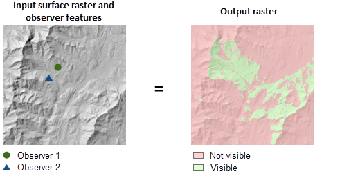

Illustration
Viewshed illustration
Viewshed output displayed on a hillshaded elevation surface

  • The visibility of each cell center is determined by comparing the altitude angle to the cell center with the altitude angle to the local horizon. The local horizon is computed by considering the intervening terrain between the point of observation and the current cell center. If the point lies above the local horizon, it is considered visible.
  • An optional above ground level (AGL) output raster is provided by the tool. Each cell on the AGL output raster records the minimum height that needs to be added to that cell to make it visible by at least one observer.
    When the input observer features contain multiple observers, the output value is the minimum of the AGL values from all of the individual observers.
