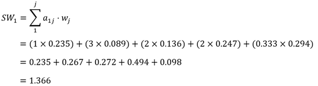

The weighted sum for each variable is calculated using the following formula:
Weighted sum of variables
Where:
  • aij is the value from the original pairwise comparison matrix where i refers to the row and j refers to the column
  • wj are the derived weights of the corresponding variables
For example, the SW for the Solar_Gain variable row is calculated as follows:
Weighted sum for Solar_Gain variable example

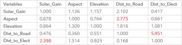

Determine the most inconsistent pairs
The εij matrix for the comparison example above is constructed as follows:
Three most inconsistent pairs are in red
The highest three values in the matrix are the comparisons that contribute most to the inconsistency. They are the comparison evaluations for variables Dist_to_Road and Dist_to_Elect, for variables Aspect and Dist_to_Road, and for variables Dist_to_Elect and Solar_Gain. The three pairs are highlighted in red on both sides of the sliders on the tool dialog box.

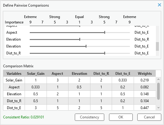

In the original comparison matrix, the variable Solar_Gain is evaluated as twice as important as Dist_to_Road (Solar_Gain > Dist_to_Road), and three times less important as Dist_to_Elect (Dist_to_Elect > Solar_Gain). Logically, Dist_to_Road should be less important than Dist_to_Elect (Dist_to_Elect > Dist_to_Road). However, in the original comparison, the evaluation incorrectly assigned Dist_to_Road a weight five times as important as Dist_to_Elect (Dist_to_Road > Dist_to_Elect). This is a main cause of the inconsistency.
To correct this, move the slider toward the Dist_to_Elect side, and review the CR again. For example, if you move the slider to position 5 on the Dist_to_Elect side, and click the Consistency button again, the new CR is 0.029, indicating that the overall comparison is now consistent.
Updated weights and consistent CR
