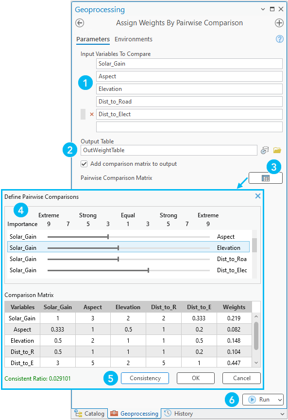

Use the tool to assign weights by pairwise comparison
The following is a common workflow for using the tool. The step numbers below correspond to the numbers in the image above.
  1. Provide the names of variables to compare in the Input Variables To Compare parameter.
  2. Optionally, alter the automatically generated Output Table parameter value.
  3. For the Pairwise Comparison Matrix parameter, click the Compare variables and calculate weights button.
    The Define Pairwise Comparisons window appears containing the Comparison Matrix table.
  4. Specify the pairwise comparisons by moving the sliders for each pair.
  5. Click Consistency to ensure that the pairwise comparisons are consistent.
  6. Click Run.

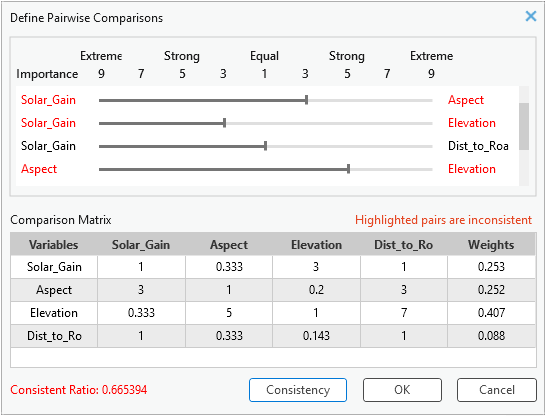

Adjust the consistency ratio
Click Consistency to review the consistency among the comparisons of all the pairs. The consistency ratio is displayed at the bottom. If the ratio is greater than 0.1, the comparisons are not consistent. The ratio is shown in red as are the three pairs that are most inconsistent (see the example below). You can adjust the inconsistent comparisons using the sliders to ensure consistency.
Pairwise Comparison Matrix with Consistency Ratio example
See Calculate the consistency ratio for a detailed discussion on how the consistency ratio is determined.
