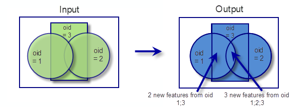

The Union tool can run with a single input feature class or layer. With a single input, instead of finding overlap between the features from the different feature classes or layers, the tool will find the overlap between features within the single input. The areas where features overlap will be separated into new features with all the attribute information of the input feature. The area of overlap will always generate two identical overlapping features, one for each feature that participates in that overlap.
The graphic below illustrates the result of the union of overlapping features within a feature class. The area of overlap is duplicated to maintain all the attributes and areas. To re-create the overlapping features, use the Dissolve tool on the output, and dissolve by all fields except the FID field.
Union example 1
