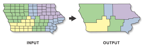

Dissolve (Data Management Tools)
Summary
Aggregates features based on specified attributes.
An alternate tool is available for dissolve operations. See the Pairwise Dissolve tool documentation for details.
Learn more about how Dissolve works
Illustration
Dissolve tool illustration
