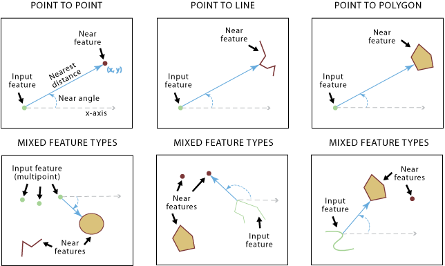

Illustration
Near tool illustration
Finding the near feature by geometry type is shown.

    • NEAR_FID—The object ID of the nearest feature. If no near feature is found, the value will be -1.
    • NEAR_DIST—The distance from the input feature to the near feature. The value is in the linear unit of the input feature's coordinate system, or meters when the Method parameter is set to Geodesic and the input is in a geographic coordinate system. If no near feature is found, the value will be -1.
    • NEAR_FC—The path of the source feature class containing the nearest feature found. The layer name will be used if layers are used as input, and the catalog path to the feature class will be used if paths are used as input. This field is only added to the output table if multiple near features are specified. If no near feature is found, the value will be an empty string or null.
    The fields below will be added to the input if the Location parameter is checked. The field values will be updated if the fields already exist. The field value units depend on the Method parameter value. If the Method parameter is set to Planar, the field value will be in the linear unit of the input feature's coordinate system. If it's set to Geodesic, the field value will be in the geographic coordinate system associated with the input feature's coordinate system.
    • NEAR_X—The x-coordinate of the location on the near feature that is closest to the input feature. If no near feature is found, the value will be -1.
    • NEAR_Y—The y-coordinate of the location on the near feature that is closest to the input feature. If no near feature is found, the value will be -1.
    The field below will be added to the input features if the Angle parameter is checked. The field value will be updated if the field already exists.
    • NEAR_ANGLE—The angle of the line at the FROM_X and FROM_Y location that connects the input features to the near feature. If no near feature is found or the near feature intersects the input feature, the value will be 0.
