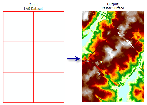

Creates a raster using elevation, intensity, or RGB values stored in the lidar points referenced by the LAS dataset.
Illustration
LAS Dataset To Raster tool illustration
