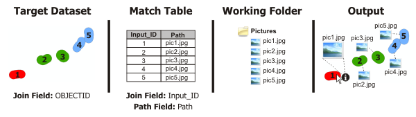

Illustration
Add Attachments tool illustration

  • Multiple files can be attached to a single feature class or table record. To accomplish this, ensure that the Match Table parameter value contains multiple records for that input ID. For example, record 1 has an input ID of 1 and a path name of pic1a.jpg, and record 2 has an input ID of 1 and a path name of pic1b.jpg.

A folder or workspace where attachment files are centralized. By specifying a working folder, the paths in the Match Path Field parameter value can be the short names of files relative to the working folder.
For example, if loading attachments with paths such as C:\MyPictures\image1.jpg and C:\MyPictures\image2.jpg, use a parameter value of C:\MyPictures. Then the paths in the Match Path Field parameter value can be the short names such as image1.jpg and image2.jpg instead of the full paths.
