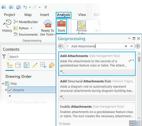

  1. On the Analysis tab in the Geoprocessing group, click Tools, and search for or browse to the Add Attachments tool in the Data Management Tools toolset.
    Geoprocessing pane with search results for Add Attachments
  2. Click the Add Attachments search result to open the tool.

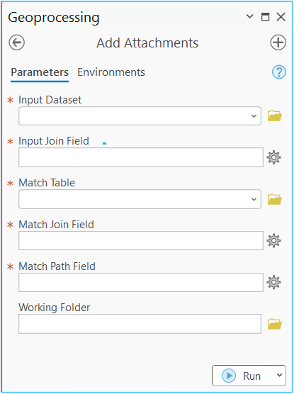

    The Add Attachments tool dialog box appears with its parameters.
    Add Attachments dialog box
  3. For Input Dataset, use the browse button to select a feature class or table, or click the down arrow to choose a dataset from the active map.
  4. For Input Join Field, choose a field from the input dataset with matching values in the match table.
    This field is the OBJECTID field if the match table was created using the Generate Attachment Match Table tool.
  5. For Match Table, choose the match table that contains the object IDs and file names that will be added as attachments.
  6. For Match Join Field, choose the field in the match table with object ID values.
    If the Generate Attachment Match Table tool created the match table, this is the MatchID column.
  7. For Match Path Field, choose the file name field in the match table.
  8. For Working Folder, use the folder or workspace containing the files being attached.
    This parameter is optional and can be left blank if the file names have a full path to the data. Otherwise, add the folder location if the file names are short (for example, image1.jpg and image2.jpg).
  9. Click Run to add the attachments.
