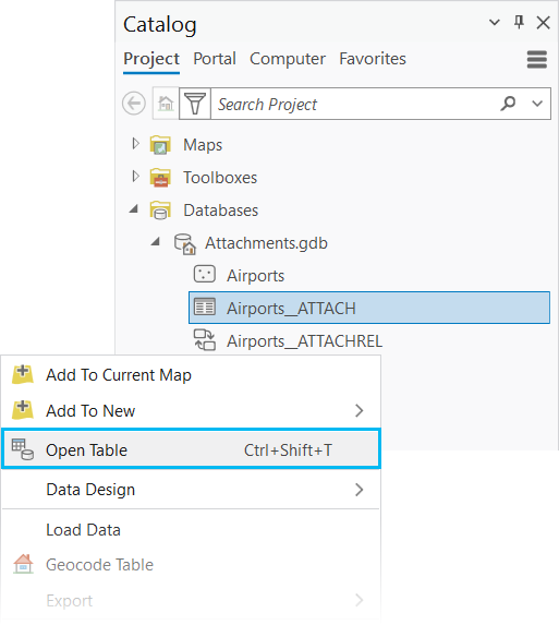

  1. In the Catalog pane, right-click the ATTACH table and choose Open Table.
    Context menu from the Catalog pane showing the Open Table option

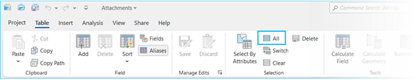

  2. On the Table tab, in the Selection group, click the All button to select all records.
    Table tab with the All button highlighted in the Selection group

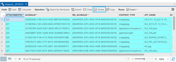

  3. With all records selected, click the Delete button on the table menu.
    ATTACH table with all records selected and the Delete button highlighted

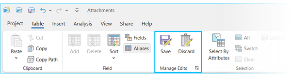

  4. On the Table tab, in the Manage Edits group, click the Save button.
    Table tab with the Save and Discard buttons highlighted in the Manage Edits group

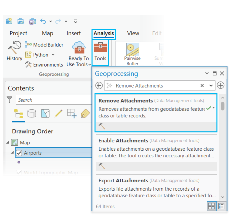

  1. On the Analysis tab. in the Geoprocessing group, click Tools, and search for or browse to the Remove Attachments tool in the Data Management Tools toolset.
    Remove Attachments search result in the Geoprocessing pane
  2. Click the Remove Attachments search result to open the tool.

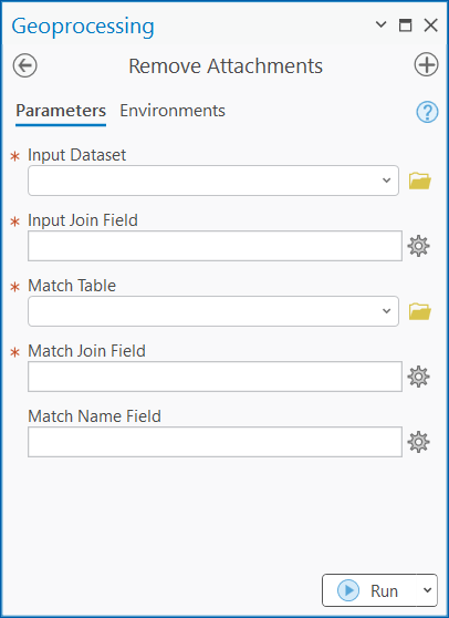

    Remove Attachments tool pane
  3. For Input Dataset, use the browse button to select a feature class or table or click the down arrow to choose a dataset from the active map.
  4. For Input Join Field, choose a field from the input dataset with matching values in the match table.
    This field is the OBJECTID field if you created the match table using the Generate Attachment Match Table tool.
  5. For Match Table, choose the match table that contains the object IDs and file names that will remove attachments.
  6. For Match Join Field, choose the field in the match table with the match Object ID values.
    If you used the Generate Attachment Match Table tool to create the match table, this is the MatchID column.
  7. For Match Name Field, choose the file name field in the match table.
  8. Click Run to remove attachments.
