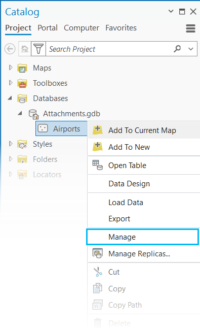

  1. Right-click a dataset in a geodatabase in the Catalog pane and choose Manage.
    Manage in context menu

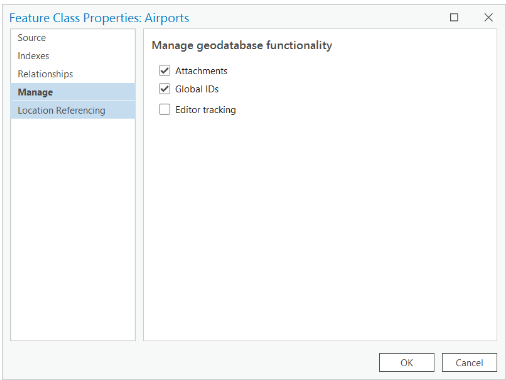

  2. In the Feature Class Properties window, check Attachments.
    Feature Class Properties window with Attachments and Global IDs checked
    Global IDs is checked by default, and it is recommended that you leave it checked.
  3. Click OK to enable the dataset.

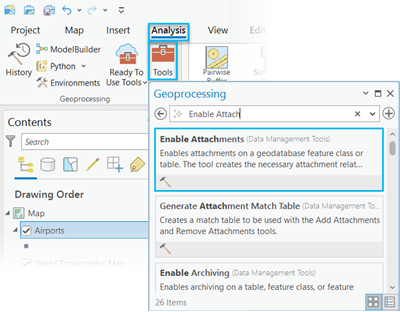

  1. On the Analysis tab in the Geoprocessing group, click Tools.
  2. Search for or browse to the Enable Attachments tool in the Data Management Tools toolset, and click the Enable Attachments search result to open the tool.
    Search results for the Enable Attachments tool

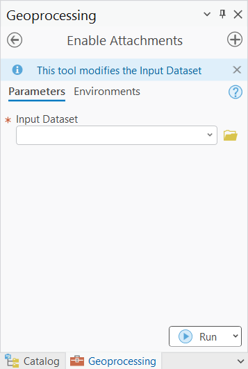

    The Enable Attachments dialog box appears with a single parameter to populate with the input dataset.
    Enable Attachments geoprocessing tool
  3. For Input Dataset, use the browse button to select a feature class or table, or click the down arrow to choose a dataset from the active map.
  4. Click Run to enable the dataset for attachments.

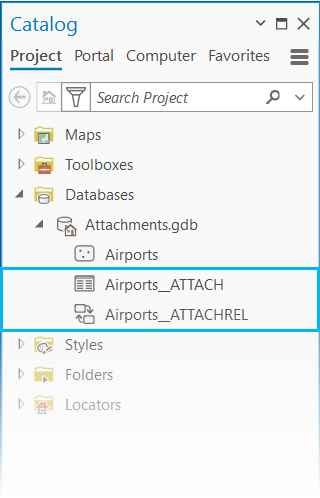

Both workflows create a stand-alone table to store all attachments and a one-to-many relationship class to manage the association between the stand-alone table and the input dataset.
The attachment table is identified by having the same name as the enabled dataset with an appending double underscore and the suffix ATTACH. The associated relationship class name also has the name of the dataset with an appending double underscore and the suffix ATTACHREL.
Catalog pane showing enabled feature class with associated ATTACH table and relationship class
