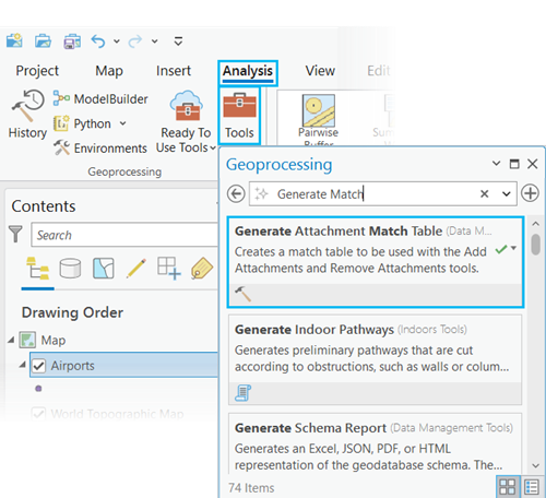

  2. On the Analysis tab in the Geoprocessing group, click Tools, and search for or browse to the Generate Attachment Match Table tool in the Data Management Tools toolset.
    Geoprocessing pane with search results for Generate Attachment Match Table
  3. Click the Generate Attachment Match Table search result to open the tool.

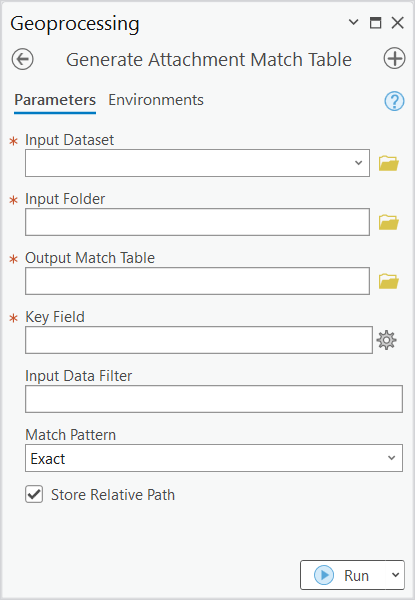

    The Generate Attachment Match Table tool dialog box appears with default settings.
    Generate Attachment Match Table dialog box

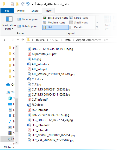

  5. For Input Folder, use the browse button to browse to the folder that contains all the files to be loaded as attachments.
    Windows File Explorer with folder of airport files to add to the match table
    Preparing file names in the folder containing the attachment files may be necessary before creating a match table and loading attachments in ArcGIS Pro. For example, the image above displays a variety of media file formats (JPG, PDF, DOCX) in the Airport_Attachment_Files folder. Each file name in this folder contains the airport code. The airport code in this example will be a key element in matching the correct files with the correct feature or row.

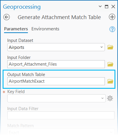

  6. For Output Match Table, provide a name for the new table.
    Output Match Table parameter populated

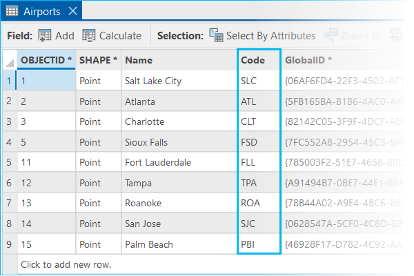

  7. For Key Field, provide a field from the dataset attribute table.
    The values of this field are used to match values in the file names of the input folder. Matching is based on the Match Pattern parameter setting. For example, you can choose the CODE field to match values in each row in the file names from the Input Folder value.
    Attribute table with highlighted key field

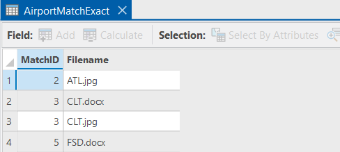

  11. Click Run to create the match table.

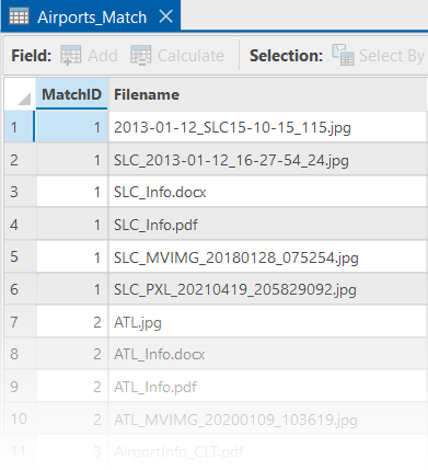

    Match table showing results with the exact match pattern from the Key Field values
    The new table has four rows that exactly match four file names (not including the file extension) in the input folder.

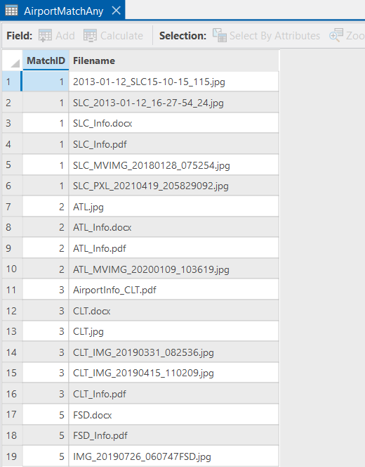

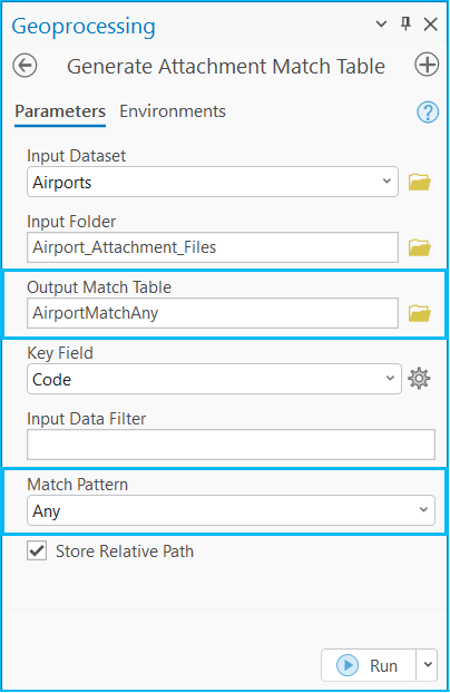

However, you can also create a match table that matches any file name in the input folder and contains the key field values for all applicable features or rows in the input dataset. To do this, change the Match Pattern parameter value to Any and provide a different name for the match table.
Output Match Table parameter with new name and Match Pattern parameter set to Any
Using the example data in the steps above and changing the Match Pattern parameter value to Any generates a match table with all file names included and matched to their respective features with the correct object ID when you click Run. In this example, a new match table was created with a new name.
Match table with results using Match Pattern set to Any
The new table has rows that matched file names (not including the file extension) with a key value in any part of the files in the input folder.

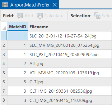

Create a match table using a prefix match pattern
Using Prefix for the Match Pattern parameter value and the same steps and data above, the tool returns values in the key field that match the value at the beginning of the file name from the input folder.
Output Match Table parameter with the new table name, Input Data Filter parameter populated for .jpg files, and Match Pattern parameter set to Prefix
The image below shows the match table results when you set the tool to match only *.jpg files using the Input Data Filter parameter. Data filters can be applied to all match patterns.
Match table with results using a *.jpg filter and Match Pattern set to Prefix
The new table has rows that matched file names (not including the file extension) with a key value at the beginning of the files in the input folder.

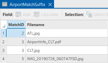

Create a match table using a suffix match pattern
You can modify the steps above by changing the Match Pattern parameter value to Suffix.
Input Data Filter parameter set to *.jpg and *.pdf and Match Pattern set to Suffix
In addition to creating a match table with Match Pattern set to Suffix, this example will only return .jpg and .pdf files in the new match table. The two filters are separated by a comma in the Input Data Filter parameter.
Match table with results using .jpg and .pdf filter and Match Pattern set to Suffix
The new table has rows that matched file names (not including the file extension) with a key value at the end of the files in the input folder.
