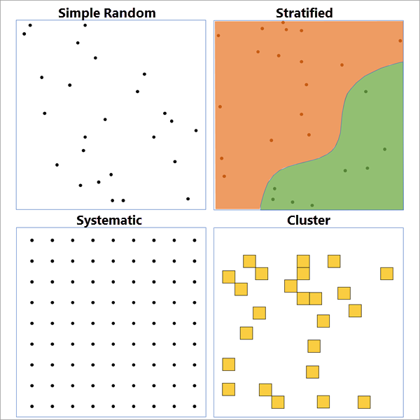

Illustration
Create Spatial Sampling Locations tool illustration

  • Sample locations can be created for the following primary sampling designs:
    • Simple random sampling—Create sample points randomly within the study area. Each location in the study area is equally likely to be selected as a sample location. The study area will be treated as a single area, and all boundaries between polygons or raster categories will be ignored (for example, a polygon feature class of all counties within a state will define the same study area as a single polygon of the entire state). Simple random sampling is useful when you want to investigate the entire study area, but no location is more important for sampling than any other location. To perform simple random sampling, specify the Simple random option for the Sampling Method parameter.
      • Example application: If the study area is a dense forest where every location can be assumed to have a tree, simple random sampling can be used to randomly sample trees within the forest.
    • Stratified random sampling—Create sample points by dividing the study area into distinct strata (such as soil class or land use type) and performing simple random sampling separately within each stratum. Stratified random sampling is useful when you want to ensure that all strata are represented in the sample. To perform stratified random sampling, specify one of the three stratification options for the Sampling Method parameter (see the next usage tip for information about each type of stratification).
      • Example application: If a national park is divided into elevation classes, stratified random sampling can be used to collect soil samples separately for each elevation class. This ensures that there will be sufficient soil sampling across all elevations in the park.
    • Systematic sampling—Create sample locations in a gridded, nonrandom pattern within the study area. The grid is created by a tessellation of regularly shaped polygons (such as hexagons, squares, or triangles). The sample locations can be returned as the tessellated polygons or as points (the centroids of the tessellated polygons). Systematic sampling is useful for ensuring that no sections of the study area are sampled more than others, which is often desirable when the goal is to create a map of the samples rather than to make inferences about the entire study area. To perform systematic sampling, specify the Systematic option for the Sampling Method parameter.
      • Example application: To study the ocean floor in a marine area, you can create a hexagonal grid of sample locations to sample marine plant species.
    • Cluster sampling—Create sample polygons by creating a systematic sample and randomly selecting some of the polygons from the tessellation. The resulting polygons are called clusters and, typically, the clusters are exhaustively studied, sampling as much as possible within each cluster. Cluster sampling is useful when you are interested in how samples interact with each other at short distances, and it is acceptable for large sections of the study area to have no samples. To perform cluster sampling, specify the Cluster option for the Sampling Method parameter.
      • Cluster sampling
      • Example application: When sampling insect colonies, cluster sampling can be used to create small areas of a plot, and all insect colonies within the clusters will be sampled.
