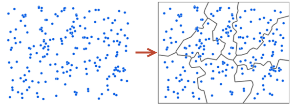

Illustration
Points (left) grouped into polygon subsets of a similar size (right)
Points (left) are grouped into polygon subsets of a similar size (right).
