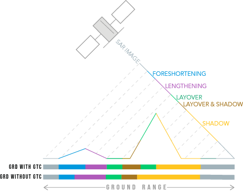

    Geometric distortions
    This figure shows distortions and how sampling of a GRD image appears with and without applying the Geometric Terrain Correction (GTC).
    In the illustration above, the blue slope facing the sensor and the magenta slope facing away from the sensor are the same length on the ground, but in the SAR image, the blue foreshortening region appears to be shorter than the magenta lengthening region. This is because the slope facing away from the sensor has more pixels than the slope that is facing the sensor.
    Layover occurs when the radar signal reaches the top of a tall feature before it reaches the base. The green section of the steep mountain is an example of layover; it appears in the same pixel as the ground surface. The brown section is a combination of layover and shadow, which appears to the right of the upper section in the SAR image, despite being located to the left of it on the ground.
    Shadow occurs when an object blocks the radar signal. The yellow slope facing away from the sensor is not illuminated. Since radar illumination is not scattered in the atmosphere, the shadows in a SAR image appear black.
