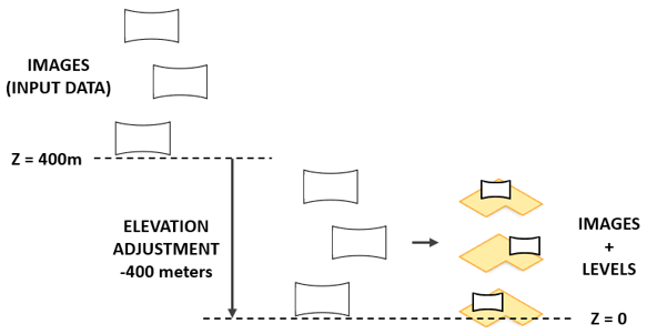

  • If the input data and input Levels layer features have different z-origins, use the Elevation Adjustment parameter to compensate for the difference. Elevation adjustment is applied after any needed reprojection of image locations.
    For example, if the input data has z-values relative to sea level, and the input Levels features have z-values relative to ground level, use a negative Elevation Adjustment parameter value to compensate for the difference. The following diagram is an example:
    Diagram of the effect of the Elevation Adjustment parameter
    A negative elevation adjustment of -400m is applied to vertically align images with Levels features.
