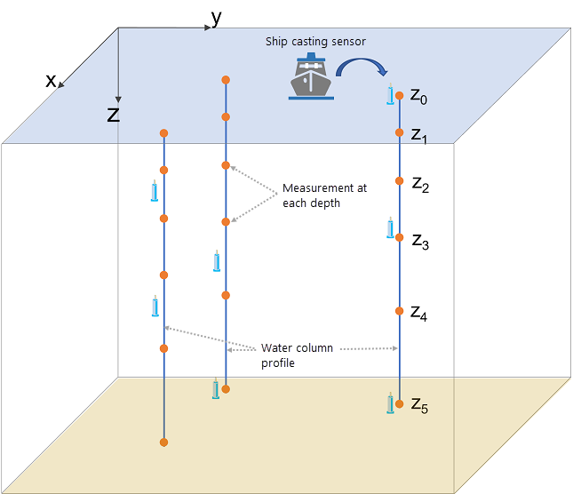

Schematic diagram showing the vertical profiles of ocean data
A schematic diagram shows how ocean vertical profiles are collected through sensors cast using ships.

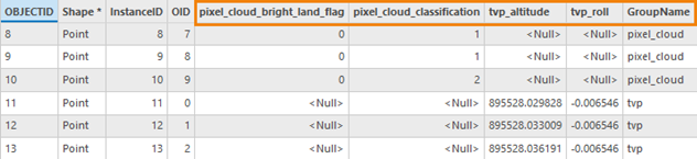

In all four tools, if the selected instance and observation variables are located within groups, the field names in the feature class attribute table and the table output will be the variable name with its relative path where forward slashes are replaced by underscores ( _ ). In the below example, the variable bright_land_flag located within the group pixel_cloud will have the field name pixel_cloud_bright_land_flag. Similarly, the variable altitude located within the group tvp will have the field name tvp_altitude. In addition, a new field named GroupName will be added to the feature class attribute table and the table output, which will contain the relative path to the group within which the variable is located (group path contains slashes but not a leading slash).
An example of an output feature layer attribute table showing the data field names and the GroupName field, when selected instance and observation variables are located within groups

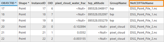

If multiple input netCDF DSG files are specified as individual files or folders, a field named NetCDFFileName will be added to the output feature class attribute table as well as the table output in all four tools, which will contain the names of the input files.
An example of an output feature layer attribute table showing the NetCDFFileName field
