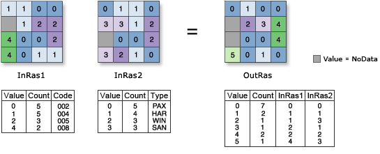

Performs a Combinatorial And operation on the cell values of two input rasters.
If both input values are true (non-zero), the output is a different value for each unique combination of input values. If one or both inputs are false (zero), the output value is 0.
Learn more about how Combinatorial tools work
Illustration
Combinatorial And illustration
OutRas = CombinatorialAnd(InRas1, InRas2)
Usage
  • The Combinatorial math tools interpret the inputs as Boolean values in which nonzero values are considered true and zero is considered false.
  • Two inputs are necessary for this combinatorial evaluation to take place.
  • The order of inputs for this tool is only relevant for the output attribute table.
