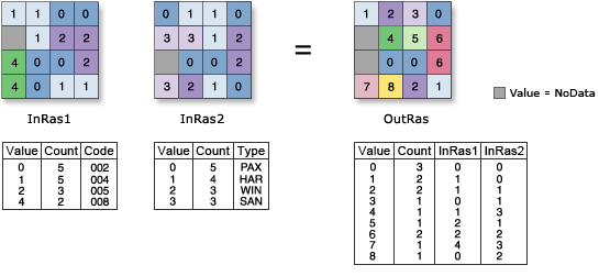

Illustration
Combinatorial Or illustration
OutRas = CombinatorialOr(InRas1, InRas2)
