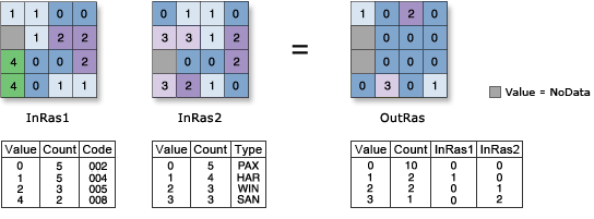

Illustration
Combinatorial XOr illustration
OutRas = CombinatorialXOr(InRas1, InRas2)
