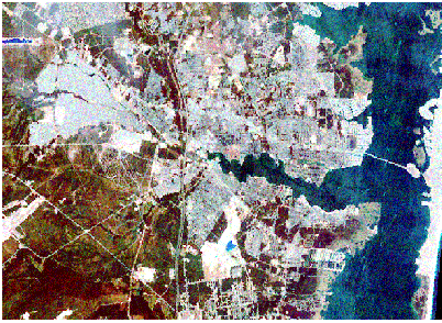

Starting with a raw satellite scene
The image below shows the raw satellite image that will be classified. While the classification process will not be explicitly described, the following section will detail some of the reasons that the direct result typically needs some further processing to be generally useful.
Raw image to be generalized

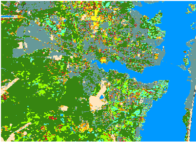

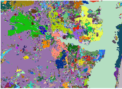

Below is the classification of the satellite image. Notice there are many small, isolated single cells or groups of cells throughout the image.
Output raster after classification
The following sections demonstrate how the generalization tools can be applied to produce a final classified raster.

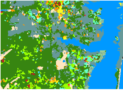

Smoothing zones with Boundary Clean
To smooth the boundaries between zones, the Boundary Clean tool can be implemented. By expanding and shrinking the boundaries, the larger zones will invade smaller zones, as is the case in the image below. Again, notice that even more of the smaller and thinner groups of cells have disappeared.
Raster after Boundary Clean applied

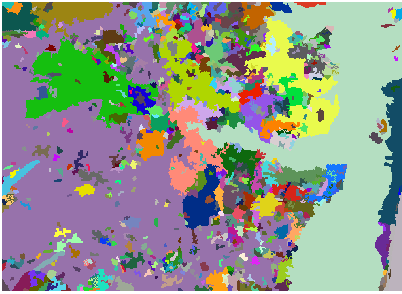

Identifying clusters with Region Group
The Majority Filter and Boundary Clean tools will only process out the single or very small clusters of a few misclassified cells by assigning them to the value that appears most frequently in the immediate neighborhood. Suppose, however, that there is a certain size threshold below which individual groupings of like cells are considered too small to be meaningful in the ensuing analysis. These clusters should instead be dissolved into the surrounding groups. For example, any contiguous clusters of the same land-use category that are smaller than 7,200 square meters in size are deemed not significant to the analysis. However, these isolated regions cannot be individually processed, since they have the same land-use value as the entire zone.
To resolve this issue, the Region Group tool is applied. This tool will assign a unique identifier to each region in the input raster (the classified image). A region is any contiguous group of cells of the same value. Consider a single zone composed of two regions that are not connected. Region Group will divide this zone into two new zones, each having a unique identification (zone) value. The original zone value is maintained as a LINK field in the output attribute table. The resulting raster is shown below and displays the many different output zones.
Raster after Region Group applied

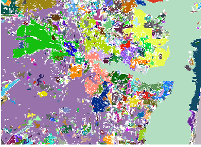

Next, using a selection tool, such as the Extract by Attributes tool in the Extraction toolbox, an output raster is created where regions smaller than the area threshold have been removed.
Very small regions selected and removed to use as a Mask

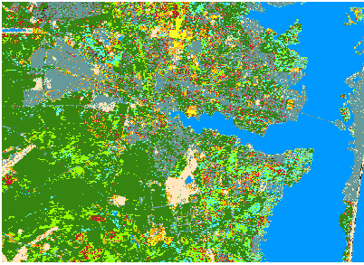

Eliminating small regions with Nibble
Using the Nibble tool on the resultant raster from the extraction tool (identifying the regions to eliminate) and with the values from the classified image raster, the tool visits each cell location to eliminate and replaces it with the closest cell with a value on the classified raster.
Small regions identified in the mask eliminated with Nibble

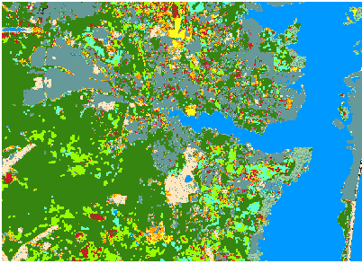

Final generalized land-use map
Using the link item from the results of the Region Group tool, the original zone values from the classified image are reassigned to the individual regions created from the Region Group tool.
The result is a more generalized land-use map, which can be used in subsequent analyses.
