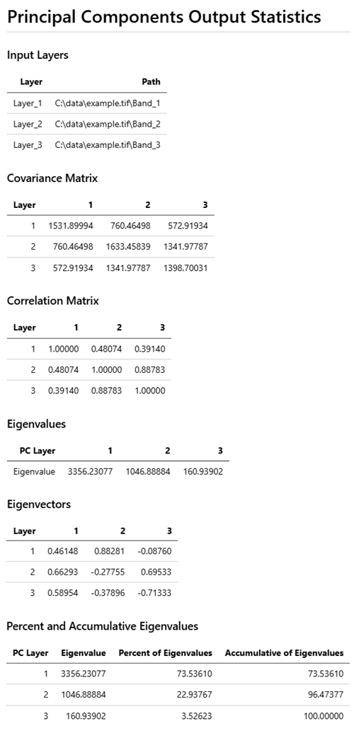

Output data file example
The output data file can be created in a comma-separated values (CSV) format or markdown format. The following is an example of the output data file in markdown format created for three principal components.
Output data file example in markdown format
