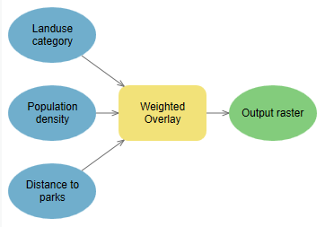

The weighted overlay model is displayed in the image below as a process in ModelBuilder:
Weighted overlay model
