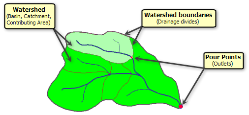

A drainage basin is an area that drains water and other substances to a common outlet. Other common terms for a drainage basin are watershed, basin, catchment, or contributing area. This area is normally defined as the total area flowing to a given outlet, or pour point.
A pour point is the point at which water flows out of an area. This is usually the lowest point along the boundary of the drainage basin.
The boundary between two basins is referred to as a drainage divide or watershed boundary.
Components of drainage basin
