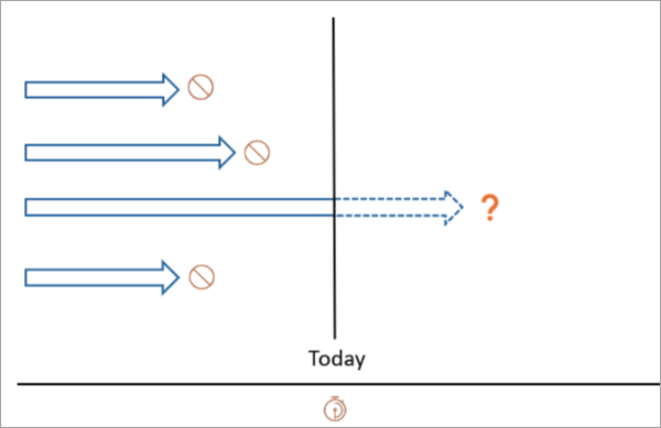

Illustration
Estimate Time to Event tool illustration
