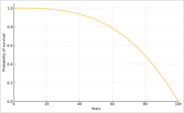

Survival curve
In this curve, the vast majority of individuals survive past age 20 before the proportion begins to accelerate downward. By age 60, slightly less than 80 percent of individuals will still be alive. The median survival time (0.5 on the y-axis) is approximately 80 years, and by 100 years, almost no individuals remain.

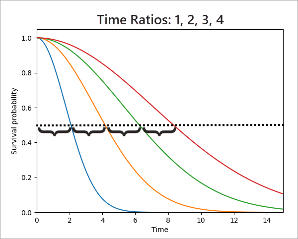

The effect of the time ratio is to stretch the survival curve horizontally. For example, the image below displays four survival curves showing the effect of time ratios equal to 1 (the blue curve being compared against), 2 (orange curve), 3 (green curve), and 4 (red curve), from left to right. It is difficult to see that the curves are stretched versions of each other, so a horizontal dashed line is drawn at the median survival time. Notice that the median survival time for time ratio 2 is twice the median time for time ratio 1. Similarly, the median survival times for time ratios 3 and 4 are three and four times the median survival time for time ratio 1, respectively. While the dashed line is placed at the median, using any other value of the y-axis will also preserve these ratios.
Survival curves stretched by time ratios

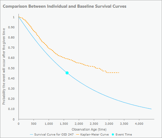

For uncensored observations, the pop-up chart will show the survival curve for the feature (blue curve) and a blue dot indicating the event time. This allows you to see whether the observation experienced the event early or late in its predicted lifespan. Observations with events much earlier or later than expected by the model may warrant further investigation. The Kaplan-Meier curve (orange curve) is also included in the pop-up chart as a basis for comparison. This allows you to see whether the observation was expected to survive longer or shorter than a typical observation. For example, in the image below, the survival curve is lower and to the left of the Kaplan-Meier curve, meaning that the event was expected to occur earlier than for most other observations. The blue dot is also in the middle of the survival curve, meaning that the event occurred approximately when the model predicted it would, based on its explanatory variables.
Pop-up chart for an uncensored observation

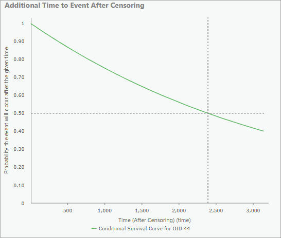

For censored features only, the pop-up charts will also contain a chart of the additional time to the event after censoring. The median additional time is drawn as dashed horizontal and vertical lines to identify the time when the model predicts a 50 percent probability that the event will have occurred. The x-axis will extend until the curve reaches 0.4 to ensure that the median is always shown.
Pop-up chart for the additional time to the event for a censored observation

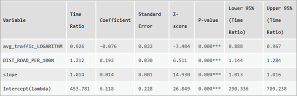

The first section of the messages contains a table summarizing the effects of the continuous explanatory variables. For each variable, the table displays the time ratio, the coefficient and its standard error (from the Weibull distribution scale parameter), the z-score and p-value testing the statistical significance of the coefficient, and the lower and upper bounds for a 95 percent confidence interval of the time ratio.
A row for the intercept term is included at the end, but the raw values typically do not have a meaningful interpretation. Instead, the purpose of the intercept is to scale the survival curves to the time unit of the age field. For example, if you converted the age field values from hours to days, all time ratios would remain the same, but the time ratio of the intercept would be divided by 24 (the conversion from hours to days). This is why the unit of the age field does not need to be specified in the tool and will give equivalent results regardless of the unit.
Coefficient table for continuous explanatory variables
Note:
For each variable, the coefficient and its standard error are directly estimated by the AFT model and tested for statistical significance using a z-test. The time ratio is then calculated from the coefficient by taking its exponential: exp(coefficent). Time ratios are usually preferred to coefficients because time ratios are interpreted relative to the raw survival time, whereas the coefficients are interpreted relative to the logarithm of the survival time. The upper and lower confidence bounds are calculated by creating a confidence interval for the coefficient and calculating the exponential of the endpoints.

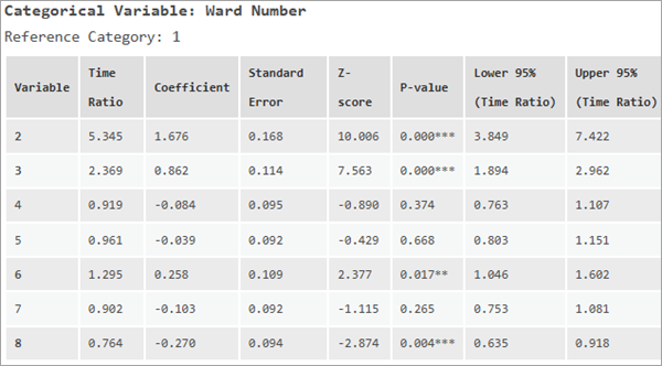

The second section of the messages contains tables summarizing the effects of the categorical explanatory variables. For each categorical variable, a table is displayed showing the effect of each of its categories. The reference category is displayed above the table, and all time ratios must be interpreted relative to this category. For example, in the image below, the categorical variable is the ward number, and the ward 1 is the reference category. Observations in ward 2 live 5.345 times longer than observations in ward 1 (time ratio equal to 5.345), but observations in ward 8 live 23.6 percent shorter than observations in ward 1 (time ratio equal to 0.764). The p-values also indicate that wards 4, 5, and 7 are not significantly different than ward 1.
Coefficient table for categorical explanatory variables
Note:
Each categorical variable is converted into a series of binary (0 or 1) variables, and these binary variables are used as continuous explanatory variables in the AFT model. For K categories, (K-1) binary variables are created, and each category receives a binary variable except the reference category (this process is called indicator encoding). One category must be excluded and used as a reference because including binary variables for all categories causes perfect collinearity, causing the model to be unable to estimate the coefficients and time ratios.
