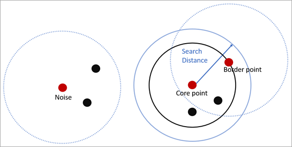

For Defined distance (DBSCAN), if the Minimum Features per Cluster parameter value can be found within the search distance from a particular point, that point will be marked as a core-point and included in a cluster, along with all points within the core-distance. A border-point is a point that is within the search distance of a core-point but does not itself have the minimum number of features within the search distance. Each resulting cluster is composed of core-points and border-points, where core-points tend to fall in the middle of the cluster and border-points fall on the exterior. If a point does not have the minimum number of features within the search distance and is not within the search distance of another core-point (in other words, it is neither a core-point nor a border-point), it is marked as a noise point and not included in any cluster.
Illustration of core-point, border-point, and noise point
Clustering four minimum features per cluster is shown. The core-point has four neighbors within the search distance (including itself). The border-point only has three features within the search distance, but it is a neighbor of a core-point, so it is included in the cluster. The noise point does not have four features within the search distance, and it is not a neighbor of a core-point, so it is not included in a cluster.

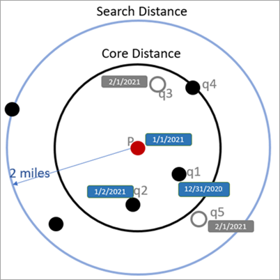

For Multi-scale (OPTICS), all points outside of the search time interval range of a point will be excluded when the point calculates its core-distance, searches all neighbor distances within the specified search distance, and calculates the reachability distance.
In the following image, the search distance is 2 miles, the search time interval is 3 days, and the minimum number of features is 4. The core-distance for point P is calculated skipping point q3 because it is outside of the search time interval. In this case, the core-distance of P is equal to the reachability distance of P.

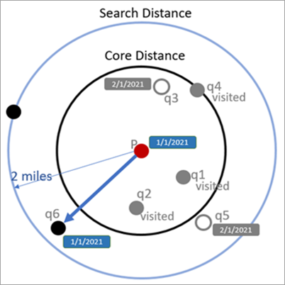

The next image shows the calculation of the reachability distance when some neighboring points have already been visited. Points q1, q2, and q4 were skipped because they were previously visited, and points q3 and q5 were skipped because they are outside of the search time window.

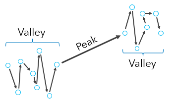

The reachability distances of peaks versus valleys
Reachability distances form peaks and valleys in the reachability plot. As longer distances are measured between points, a peak results in the reachability plot.
Plateaus can occur in a reachability plot when the search distance is less than the largest core-distance. A key aspect of using the OPTICS clustering method is determining how to detect clusters from the reachability plot, which is done using the Cluster Sensitivity parameter.

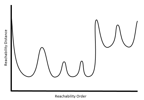

While only Multi-scale (OPTICS) uses the reachability plot to detect clusters, the plot can be used to help explain, conceptually, how these methods differ. For the purposes of illustration, the reachability plot below will be used to explain the differences in the three methods. The plot reveals clusters of varying densities and separation distances. We'll explore the results of using each of the clustering methods on this illustrative data.
Conceptual reachability plot
A conceptual reachability plot is shown with clusters of points with varying densities and distances between them.

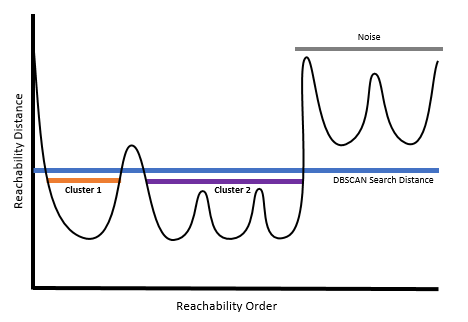

For Defined distance (DBSCAN), you can imagine drawing a line across the reachability plot at the specified search distance. Areas below the search distance represent clusters while peaks above the search distance represent noise points. Defined distance (DBSCAN) is the fastest of the clustering methods, but is only appropriate if there is a clear search distance to use as a cutoff, and that search distance works well for all clusters. This requires that all meaningful clusters have similar densities.

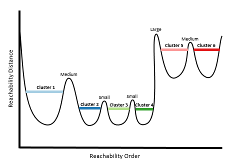

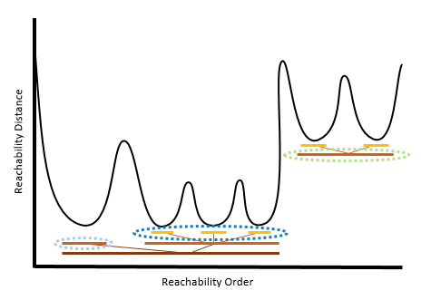

For Multi-scale (OPTICS), the work of detecting clusters is based not on a particular distance, but instead on the peaks and valleys within the plot. Let's say that each peak has a level of either Small, Medium, or Large.
Illustration of the intensity of the peaks in the reachability plot
Choosing a very high Cluster Sensitivity essentially means that all peaks, from Small to Large, will act as separations between clusters (resulting in more clusters).
Illustration of high cluster sensitivity
An illustration shows the impact of a high cluster sensitivity used with OPTICS and the corresponding clusters.

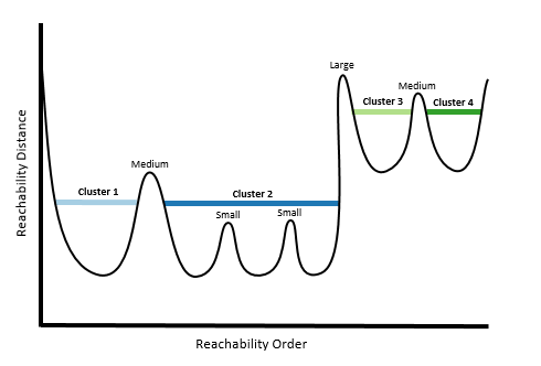

Choosing a moderate cluster sensitivity will result in both the Medium and Large peaks being used, but not the Small peaks.
Illustration of moderate cluster sensitivity
An illustration shows the impact of a moderate cluster sensitivity used with OPTICS and the corresponding clusters.
Choosing a very low cluster sensitivity will result in only the Large peaks being used, resulting in the lowest number of clusters detected.
Illustration of low cluster sensitivity
An illustration shows the impact of a low cluster sensitivity parameter used with OPTICS and the corresponding clusters.
