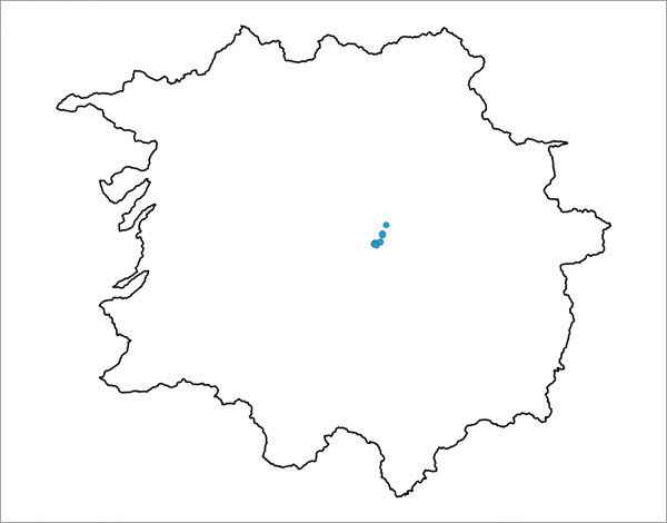

Automatic creation of background points using raster cells
When the Contains Background Points parameter is unchecked, the tool uses the coarsest cell centroids of intersecting Explanatory Training Rasters parameter values in the study area to automatically create background points.

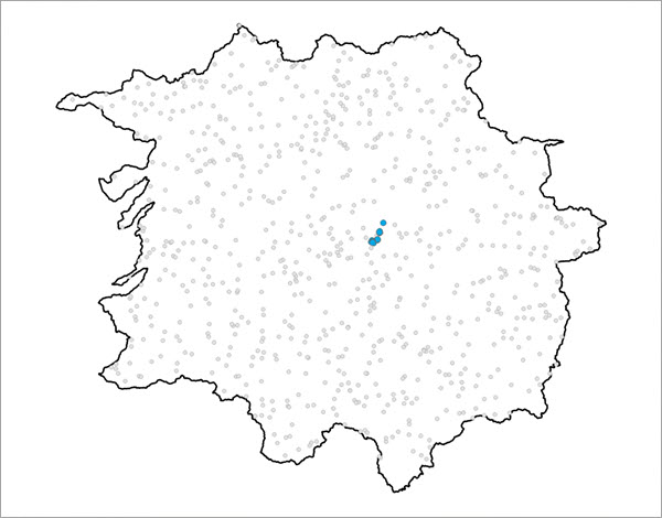

Input point features contain background points
If your input point features contain background points, you can use the Contains Background Points and Presence Indicator Field parameters with field values that designate each location as presence (1) or background (0).
Using background points in the Input Point Features

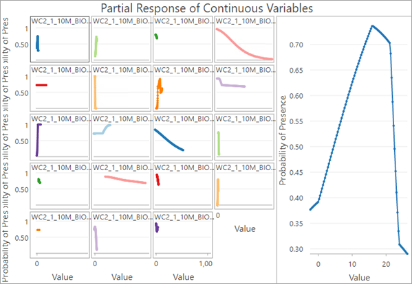

    The tool uses multiple transformed versions of each explanatory variable when attempting to model complex conditions that promote the presence of a phenomenon. For example, a model that uses annual mean temperature to estimate the probability of presence of a desert turtle species may use different variable expansions to describe a complex relationship between temperature and desert turtle habitats.
    Partial response plot of annual mean temperature and species presence
    The above partial response plot displays the marginal response of the probability of presence as the annual mean temperature changes. Keeping all other factors the same, the probability of presence does the following:
    • Increases in a linear manner as the annual mean temperature increases between 0 and 15 degrees Celsius
    • Gradually diminishes between 15 and 21 degrees Celsius
    • Decreases rapidly for annual mean temperature values above 21 degrees Celsius

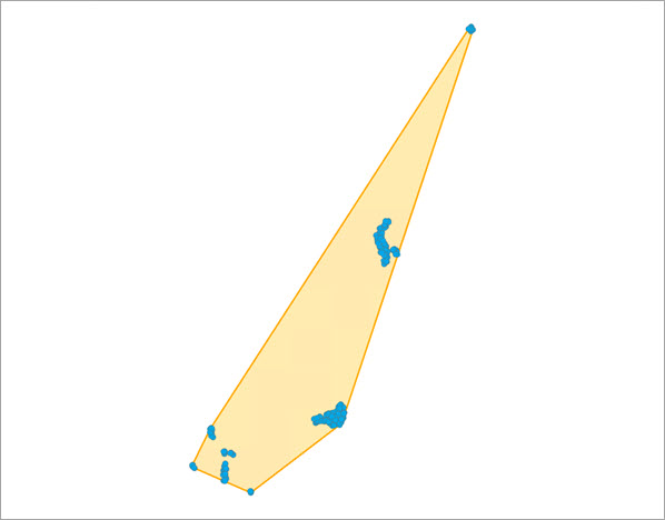

  • Convex hull—Uses the convex hull of the input point features.
    Convex hull study area

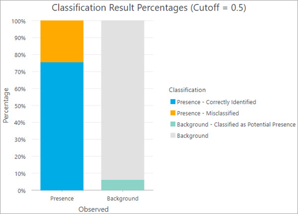

  • Classification Result Percentages—Used to assess the portion of correct predictions using the observed classification in the training features.
    Classification Result Percentages chart

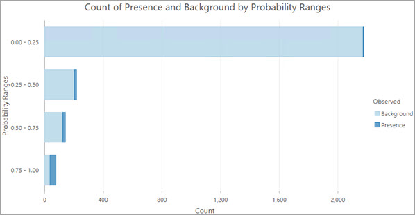

  • Count of Presence and Background by Probability Ranges—Used to compare how the model's distribution of presence probability values compare with observed presence and background classifications.
    Count of Presence and Background by Probability Ranges chart

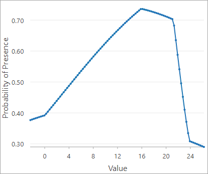

The Partial Response of Continuous Variables chart is composed of multiple charts; each chart visualizes the effect of changing values in each explanatory variable on presence probability, while keeping all other factors the same.

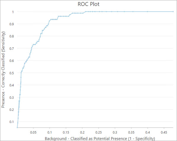

  • ROC Plot chart—Used to compare the portion of correctly classified known presence points, known as the sensitivity of the model, and the portion of background points that were classified as presence. Like the Omission Rates chart, this comparison is made across a range of presence probability cutoff values between zero and one.
    ROC Plot chart

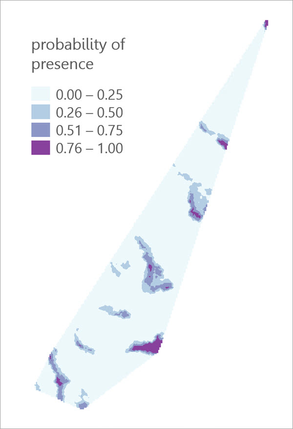

You can also use the Output Prediction Raster parameter to create a raster containing the results of the model’s predictions applied to each cell in the extent of the intersection of the rasters provided in the Match Explanatory Rasters parameter. Using this parameter provides a prediction surface across the extent of the environmental conditions available for the prediction locations.
Output prediction raster symbology and legend
The output prediction raster differs from the output training raster in that the training raster is generated only for the extent of the training data that was used in the model, and the prediction raster is generated for the extent of the input prediction features and the intersection of their matched explanatory rasters.

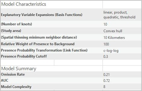

Model Characteristics messages
The Regression Coefficients table shows the explanatory variables used in the training of the model after regularization. Each entry includes the explanatory variable name, the corresponding basis expansion, and the resulting coefficient. The names of the explanatory variables indicate the nature of the basis expansion; for example, a product variable composed of the product of an Elevation variable and a ClimaticWaterDeficit variable is named product(ELEVATION, CLIMACTICWATERDEFICIT). Coefficients are rounded to four decimal places.
Regression Coefficients messages
The Cross-Validation Summary table includes each cross-validation group’s ID, count of observations in its training validation subsets, percent of observed presence features predicted as presence, and percent of observed background features predicted as background.
Cross-validation diagnostics in geoprocessing messages
The Explanatory Variable Range Diagnostics table includes each provided explanatory variable (whether in the form of a field, a distance feature, or a raster), its minimum and maximum values found in the training data, and, if input prediction features are used, the minimum and maximum values found in the prediction data.
Explanatory Variable Range Diagnostics messages

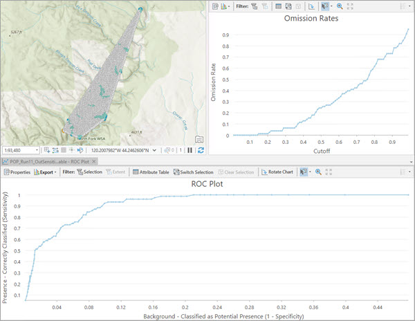

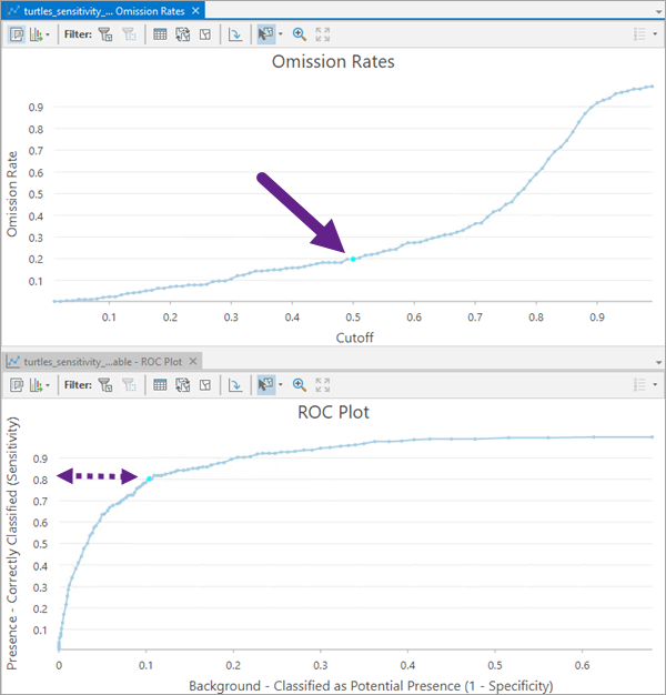

To decide an appropriate value for the Presence Probability Cutoff parameter, use the Omission Rates and ROC Plot charts
The Omission Rates chart visualizes how several Presence Probability Cutoff parameter values result in different rates of incorrectly classified presence points, otherwise known as the omission rate. While having an omission rate close to 0 is desired, it is also important not to lower the cutoff value simply for the sake of minimizing the omission rate, as this will also minimize how many background points are classified as potential presence (a useful result, in many scenarios).
To evaluate how different cutoff values impact the rate of background points being classified as presence, use the ROC Plot chart. It includes a comparison between correctly classified presence points and background classified as potential presence across different presence probability cutoff values.
ROC Plot chart
The objective of an ROC Plot chart differs depending on the nature of background points. When background points represent absence and the Relative Weight of Presence to Background parameter value is 1, the chart may be used as a traditional ROC chart in which the sensitivity (correctly classified presence points) is maximized and the 1-specificity (background or absence classified as presence) is minimized. In this case, cutoff values close to the upper left corner of the chart are more appropriate. When background points represent unknown but possible occurrence, the ROC plot demonstrates how different cutoff rates impact how many potential background locations have been estimated to be presence.
It is recommended that you use both charts in conjunction. As you evaluate the omission rates chart for the default cutoff of 0.5, select the candidate cutoff point in the Omission Rates chart, and compare this entry in the ROC Plot chart.
Map with Omission Rates and ROC Plot charts

The Classification Result Percentages chart displays a comparison of the observed and predicted classifications. You can use the chart to assess the model’s ability to predict performance on known presence points. For example, you may assess the model’s performance on predicting presence on known presence points by focusing on the portion of misclassified presence points. In use cases in which presence prediction on background points is important, you can also use the chart to view and select the background points that are predicted to have presence.
Classification Result Percentages chart used to evaluate true and false positives

    Open the Omission Rates and the ROC Plot charts side by side. Select the default presence probability cutoff of 0.5 in the omission rates plot and note the resulting sensitivity on the ROC plot's y-axis.
    Omission rates plot and ROC plot signifying cutoff value's corresponding sensitivity value

  3. Interpret the area under the curve (AUC) in the ROC plot, which is an evaluation diagnostic for how capable the model is at estimating known presence locations as presence and known background locations as background. The higher the area under the curve, the more appropriate the model for the presence prediction task.
    ROC plot showing area under the curve
    While the area under the curve is a helpful general evaluation diagnostic, it is important to decide whether the objective of the model is to reduce false positives (in other words, ensure that predicted presence is very likely to indeed be presence) or to reduce false negatives (in other words, ensure that predicted nonpresence is very likely to indeed be absence). A balance of the two objectives is the ROC plot value closest to the upper left of the chart.
    ROC plot showing cutoff values that balance sensitivity and specificity
