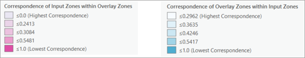

The two global correspondence measures used to calculate the V-Measure can each be partitioned spatially into each intersection of the input and overlay zones. Each of these intersections measures the correspondence of a particular combination of input and overlay zone, such as the correspondence between corn (crop type) and well-drained soil (soil drainage class). These specific combinations can be created using the Output Features parameter or the Output Raster parameter, depending on whether the zones were specified as polygons or rasters. Unlike the global association and correspondence measures, smaller values of the local correspondence measures indicate higher correspondence of zone combinations. The minimum value of 0 indicates perfect correspondence, and the local measures have no upper bound, but they are rarely greater than 2.

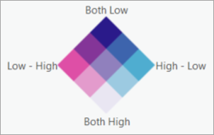

When added to a map, the output feature or raster appears in a color scheme simultaneously showing the correspondence of a specific input zone within a specific overlay zone and the correspondence of the input zone within the overlay zone. Lighter shades of blue indicate higher correspondence of the overlay zone within the input zone, and lighter shades of pink indicate higher correspondence of the input zone within the overlay zone. Areas displayed in the lightest shade of gray indicate the highest correspondence in both directions, and the darkest shade of purple indicates the lowest level of correspondence in both directions.
Bivariate color scheme

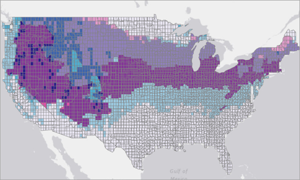

For example, the image below shows the intersections of temperature regions and climate zones. The highest levels of overall correspondence are in most southern and northern regions of the country, indicated by the light gray intersection areas. The lowest levels of correspondence are along the middle and western regions.
Intersections of climate and temperature zones

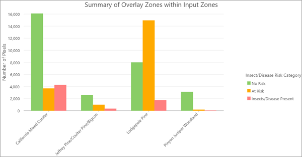

The intersections also come with two charts to visualize the correspondence of specific zone combinations. The first chart is the Summary of Overlay Zones within Input Zones, a side-by-side bar chart split by each category of the input zones. Each of the side-by-side bar charts shows the intersection area of the overlay zones with the input zone.
For example, in the image below, the input zones are forest type, and the overlay zones are insects and disease risk category. For each forest type, a bar chart is shown for the area of intersection within each of the insects and disease risk categories. The bar chart on the far left shows that the California Mixed Conifer forest type largely intersected with the No Risk category; however, approximately one-third of the area is either At Risk or already has Insects/Disease Present. For the Lodgepole Pine forest type, only about one-third of the area is not at risk, but only a small percentage of the forest already has insects/disease present. For the Pinyon Juniper Woodland forest type on the far right, only a small fraction is at risk or currently has insects or disease present. All three bars are shorter for pinyon juniper woodland than California mixed conifer and lodgepole pine because this type of forest has a smaller overall area within the study domain.
Chart summarizing the overlay zones within the input zones
