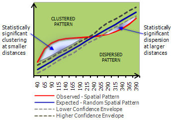

Illustration
Multi-Distance Spatial Cluster Analysis tool illustration
Measure of spatial clustering/dispersion over a range of distances.

  • Tool output is a table with fields: ExpectedK and ObservedK containing the expected and observed K values, respectively. Because the L(d) transformation is applied, the ExpectedK values will always match the Distance value. A field named DiffK contains the Observed K values minus the Expected K values. If a confidence interval option is specified, two additional fields named LwConfEnv and HiConfEnv will be included in the Output Table as well. These fields contain confidence interval information for each iteration of the tool, as specified by the Number of Distance Bands parameter.
  • When the observed K value is larger than the expected K value for a particular distance, the distribution is more clustered than a random distribution at that distance (scale of analysis). When the observed K value is smaller than the expected K value, the distribution is more dispersed than a random distribution at that distance. When the observed K value is larger than the HiConfEnv value, spatial clustering for that distance is statistically significant. When the observed K value is smaller than the LwConfEnv value, spatial dispersion for that distance is statistically significant. Additional information about interpretation is found in How Multi-Distance Spatial Cluster Analysis (Ripley's K-function) works .
