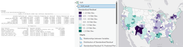

The GLR tool generates several outputs, including a map of the regression residuals, charts, and a summary report. The regression residuals map shows the under- and overpredictions from your model, and analyzing this map is an important step in finding a good model. The summary report is largely numeric and includes all the diagnostics you will use when going through the six checks below.
GLR outputs
Output from the GLR tool includes a summary report, charts, and a residuals map.

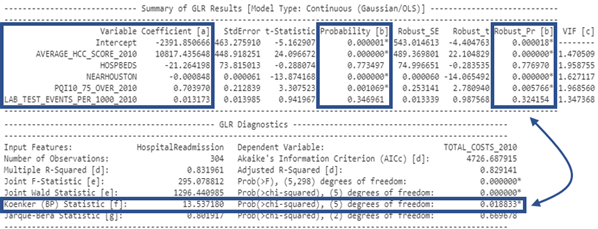

How will you know which explanatory variables are significant? The GLR tool calculates a coefficient for each explanatory variable in the model and performs a statistical test to determine whether that variable is helping your model or not. The statistical test computes the probability that the coefficient is actually zero. If the coefficient is zero (or very near zero), the associated explanatory variable is not helping your model. When the statistical test returns a small probability (p-value) for a particular explanatory variable, however, it indicates that it is unlikely (there is a small probability) that the coefficient is zero. When the probability is smaller than 0.05, an asterisk next to the probability on the GLR summary report indicates the associated explanatory variable is important to your model (in other words, its coefficient is statistically significant at the 95 percent confidence level). So you are looking for explanatory variables associated with statistically significant probabilities (look for ones with asterisks).
The GLR tool computes both the probability and the robust probability for each explanatory variable. With spatial data, it is not unusual for the relationships you are modeling to vary across the study area. These relationships are characterized as nonstationary. When the relationships are nonstationary, you can only trust robust probabilities to tell you whether an explanatory variable is statistically significant.
How will you know if the relationships in your model are nonstationary? Another statistical test included in the GLR summary report is the Koenker (Koenker's studentized Breusch-Pagan) statistic for nonstationarity. An asterisk next to the Koenker p-value indicates the relationships you are modeling exhibit statistically significant nonstationarity, so be sure to consult the robust probabilities.
Koenker diagnostic
When the Koenker p-value is statistically significant (asterisk), you can only trust the robust probabilities.
