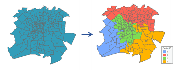

Illustration
Spatially Constrained Multivariate diagram

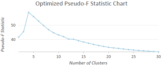

  • Sometimes you know the Number of Clusters most appropriate for your data. If you don't, however, you may have to try different numbers of clusters, noting which values provide the best group differentiation. When you leave the Number of Clusters parameter empty, the tool will evaluate the optimal number of clusters by computing a pseudo F-statistic for clustering solutions with 2 through 30 clusters and report the optimal number of clusters in the messages window. When you specify an optional Output Table for Evaluating Number of Clusters parameter value, a chart will be created showing the F-statistic values for solutions with 2 through 30 clusters. The largest F-statistic values indicate solutions that perform best at maximizing both within-cluster similarities and between-cluster differences. If no other criteria guide your choice for Number of Clusters, use a number associated with one of the largest pseudo F-statistic values.
    Pseudo-F Statistic Chart for finding optimal number of clusters
