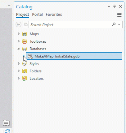

You can create a dataset in a geodatabase to add a table and manually create the fields for the FeatureLevelMetadata table.
To configure the table manually, complete the following steps:
  1. In the Catalog pane, right-click the geodatabase, and click New > Table.
    Adding a table to a geodatabase in the Catalog pane
    The Create Table pane appears.
  2. Name the table FeatureLevelMetadata and, optionally, provide an alias in the Alias text box.
  3. To add the table to the active map as you create it, check the Add output dataset to current map check box.
  4. Click Next.
  5. Configure the required MetadataFavoriteName and MetadataTokens fields along with any of the other feature-level metadata attributes that exist in the feature classes to update.
  6. Click Next.
  7. Specify the database storage configuration, and click Finish.
    The table is added to the geodatabase, and if you checked the Add output dataset to current map check box, the table is also added to the active map. You can now add metadata favorites in the table.
