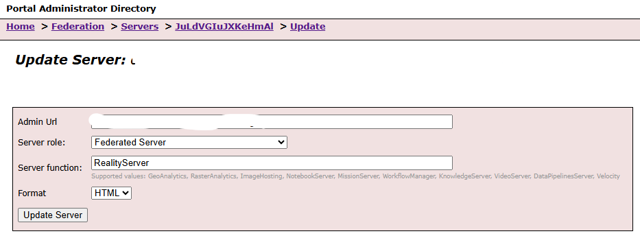

  8. Configure Reality Server role.
    • Sign in to the Portal Admin Directory as an administrator https://webadaptorhost.domain.com/<webadaptorname>/portaladmin.
    • Navigate to: Federation > Servers.
    • Click on the Reality Server.
    • Click update.
    • In the Server function field, enter Reality Server
    • Click Update Server to apply the change.
    Configure Reality Server role in Portal Admin
