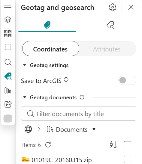

To set up geotagging by coordinates, complete the following steps:
  1. From the map tools, click Geotag and geosearch .
    The Geotag and geosearch pane appears with the Geotag documents tab open.
    Geotag tab with the Coordinates tab open
  2. Ensure Coordinates is selected.
    You can begin geotagging by coordinates to save documents' location information only to SharePoint. To save document geographic information to ArcGIS, proceed to step 3 before beginning to geotag.
  3. To save your geotagged points to a new feature layer as well as SharePoint, use the Save to ArcGIS toggle button.

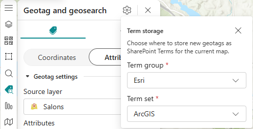

ArcGIS for SharePoint configures a SharePoint Term group and Term set to store the terms created using the geotagging workflow for each web part.
By default, geotagged terms are stored in a global term group and term set. Term storage allows you to store the terms in a specific site-level term group/ term set, or a different global term group and term set.
  2. Ensure Attributes is selected.
  3. Click Settings .
  4. The Term storage pane appears.
    Term storage pane
  5. Set a term group from the Term group drop-down menu.
  6. Set a term set from the Term set drop-down menu.

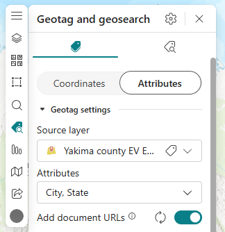

After you add data to the map, you can specify the attribute from a layer's data to use for geotagging. When a user in edit or view mode drags documents onto a configured layer, the selected attribute is used to generate a geotag for those documents. This allows you to find documents related to specific attribute values when you click a feature on the map.
You can specify one spatial attribute for each layer in a map. To set geotagging attributes, complete the following steps:
  1. Activate edit mode for the map.
  2. From your SharePoint or ArcGIS content, add the layer containing the attribute you want to use for geotagging to the map.
  3. From the map tools, click Geotag and geosearch .
    The Geotag and geosearch pane appears with the Geotag documents tab and the Coordinates settings open.
    Note:
    The map must contain at least one feature layer before documents can be geotagged.

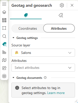

  4. At the top of the pane, click Attributes.
  5. Choose the layer to use for geotagging from the Source layer drop-down menu.
    The layer's attributes are listed.
  6. Select attributes from the Attributes drop-down menu to use it for geotagging.
    Tip:
    Hover over an attribute to see a preview of its tags. The first five unique values are shown.
Once an attribute is selected, the Geotag documents section of the pane is enabled. You can now geotag documents.
Make document links available in ArcGIS
With the SharePoint page in edit mode, ArcGIS organization administrators or layer owners can turn on the Add document URLs toggle button when geotagging by attributes. This button allows any users who geotag documents while the page is in edit mode to add the links of the documents to an ArcGIS hosted feature layer. This creates a column in the feature table for the layer and displays the link in the pop-up of a feature when viewed in Map Viewer, for example. This allows users who do not use SharePoint frequently to access document links in Map Viewer.
Turning off the Add document URLs toggle button does not remove existing links in the feature table, but newly geotagged documents will not be stored in the feature table.

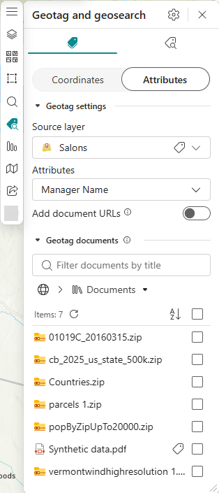

  2. Click Geotag documents to expand the section.
    A list of document libraries from the current SharePoint site appears.
  3. Optionally, click the Site picker button to change the subsite or hub site and browse for other content.
    Geotag documents section of the Geotag and geosearch pane
  4. Choose a document library (folder) to view its contents.

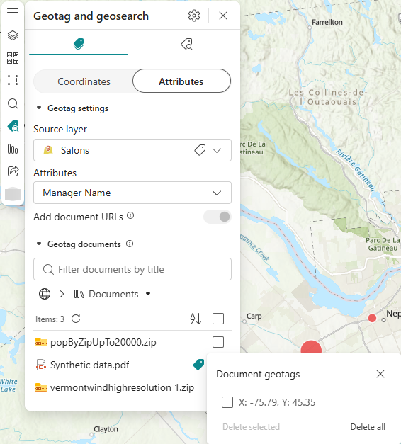

  5. If an item is already geotagged, click the Document geotags button to view the document tags associated with the item.
    Tagged document with available tags
    Tip:
    To remove document tags, select a geotag in the Document geotags pane and click Delete selected to remove selected tags or Delete all to remove all tags.
  6. Click the Close button to close the Document geotags pane.
  7. Select an item and drag it to a location on the map to geotag it.
