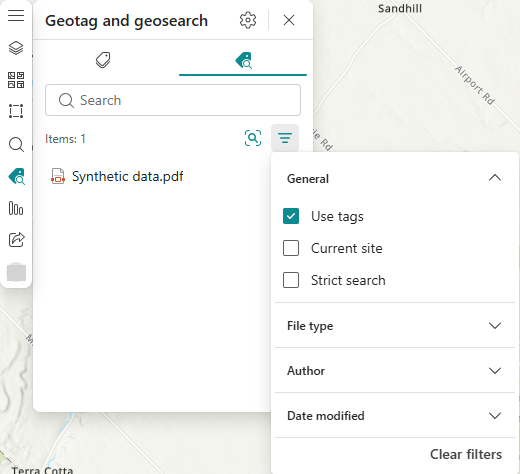

  3. Click the Search filters button and under the General section, choose the filter options for the search:
    • Use tags—This option is checked by default. SharePoint uses the tagged attribute values to search for and find documents matching the tagged values in the configured term set.
      Search filters pane
    • Current site—When checked, the search is restricted to the current SharePoint site, hub site, or subsite. This option can be turned off in edit mode.
    • Hide this option for Viewers Hide this option for Viewers—This button is only available to users when in edit mode to turn on or off the Current site filter for Viewers. By default, the filter is on and a Hide this option for Viewers button displays. To turn off the Current site check box for site users, click the Hide this option for Viewers button to hide the option from site users.
    • Strict search—When checked, the search for documents must precisely match the search keywords provided.
  4. Optionally, use the filters under the other sections in the filters pane:
    • Layers—Choose layers from the map to see results from specified layers.
    • File type—View by document type. This option lists the various document types and the number of documents of that type in the search results. Click a result to show documents of that type.
    • Author—View documents by author. This option lists the document authors and number of documents attributed to them in the search results. Click an author to display documents created by them.
    • Date modified—Search results are filtered based on the last time a document was modified. The choices are All Time, Today, Yesterday, Last 7 days, Last 30 days, or a Custom range of dates.
    Optionally, click Clear filters to clear the selection.
  5. Click anywhere on the map frame to close the filters pane.

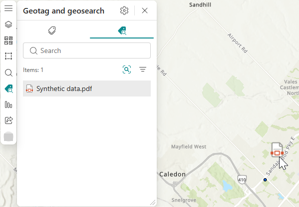

  6. To search for geotagged documents, do one of the following:
    • Click a feature on the map to search for geotagged documents.
      Documents in the Geosearch documents pane match the feature geotags
    • Click the Use map extent button to search for documents as you pan and zoom the map.
      Note:
      This functionality only works for documents tagged by coordinates.
    Document search results appear in the Geotag and geosearch pane. You can click the document to open it in a new tab and preview it. Click the Information button to see a preview of the document, the date the document was last modified, a list of contributors, and a description of the document.
