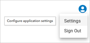

To access the app settings, complete the following steps:
  1. Sign in to the app as an administrator.
  2. Click the User button and click Settings.
    Profile menu with the Settings option highlighted
    The Topographic Production Manager dialog box appears with the app's settings.
  3. Update the settings as necessary.
  4. Click Update to save the changes or click Close to close the dialog box.
The Topographic Production Manager dialog box closes and the TPM app opens with the settings you configured.
