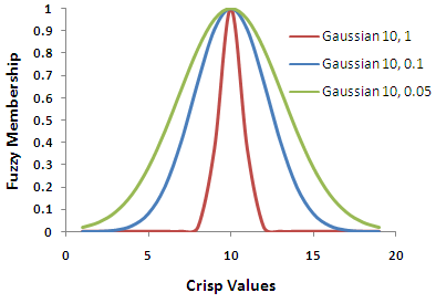

Fuzzy Gaussian graph
Variations of the Fuzzy Gaussian membership function.
