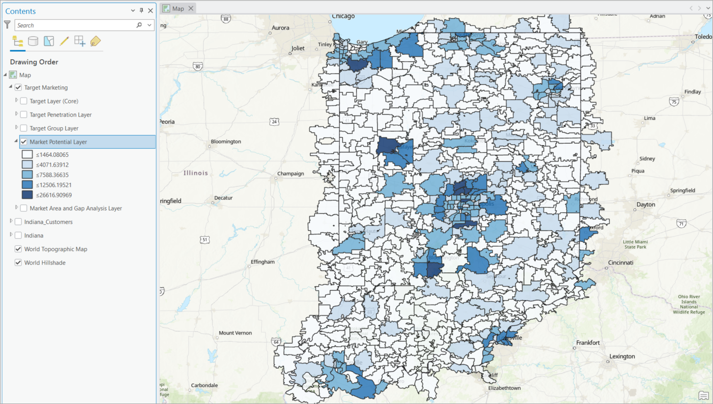

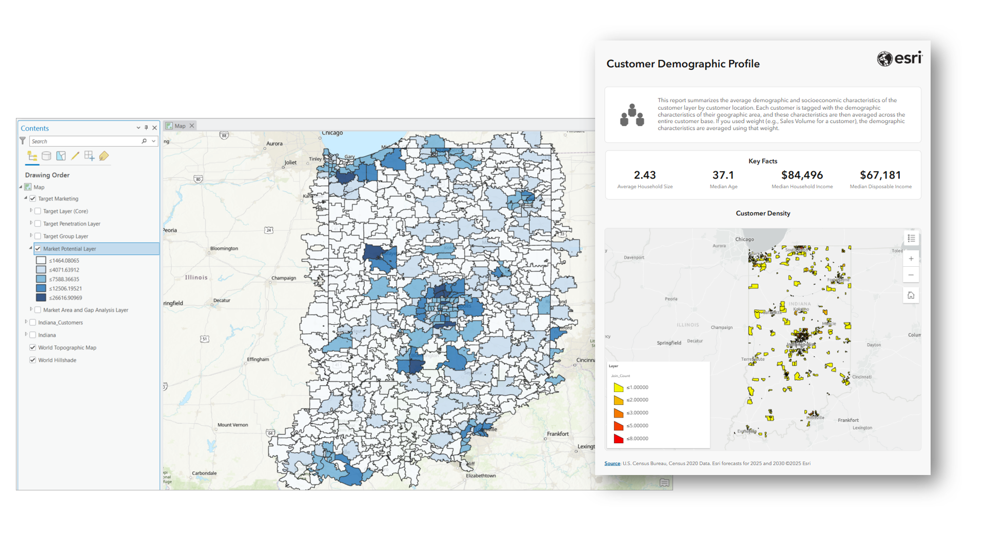

Example
An athleisure clothing company wants to understand where they should focus their outreach efforts based on their customer data points. They use target marketing to create a profile of their customer base, designing targets that represent their best customers (known as "Core" targets) as well as their occasional customers (known as "Developmental" targets). The profile reveals that their customers largely belong to segments of young, educated residents in urban neighborhoods and young, high-earning, mobile urban professionals. The clothing company creates map layers and reports that illustrate how well the company is currently penetrating these markets, and where further growth might be found.
Example layer and report

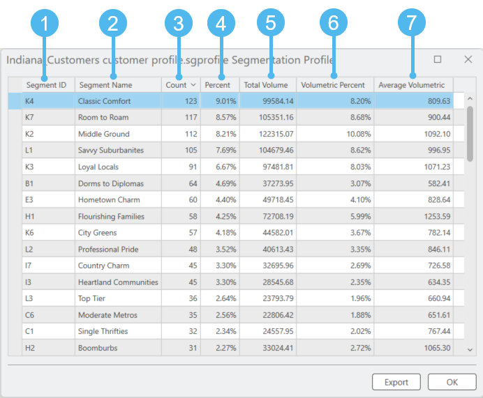

Customer profile catalog item
Customer profiles are stored as items in the Target Marketing subfolder of the Business Analyst node in the Catalog pane. You can also open the customer profile using the Customer Profile button on the four-quadrant analysis chart.
Customer profile with call-outs
Element Name Description
1 Segment ID The alphanumeric code for a segment. In this example, the segment ID comes from ArcGIS Tapestry data.
2 Segment Name The descriptive name of a segment. In this example, the segment name comes from ArcGIS Tapestry data.
3 Count The number of your customer points located within block groups in which this segment is the predominant segment.
4 Percent The percentage of your customer points located within a block group in which this segment is the predominant segment.
5 Total Volume The sum of the volume field for all customers located within block groups in which this segment is the predominant segment.
6 Volumetric Percent The percentage of the total volume for all customers located within block groups in which this segment is the predominant segment.
7 Average Volumetric The average of the volume field across all customers located within block groups in which this segment is the predominant segment.

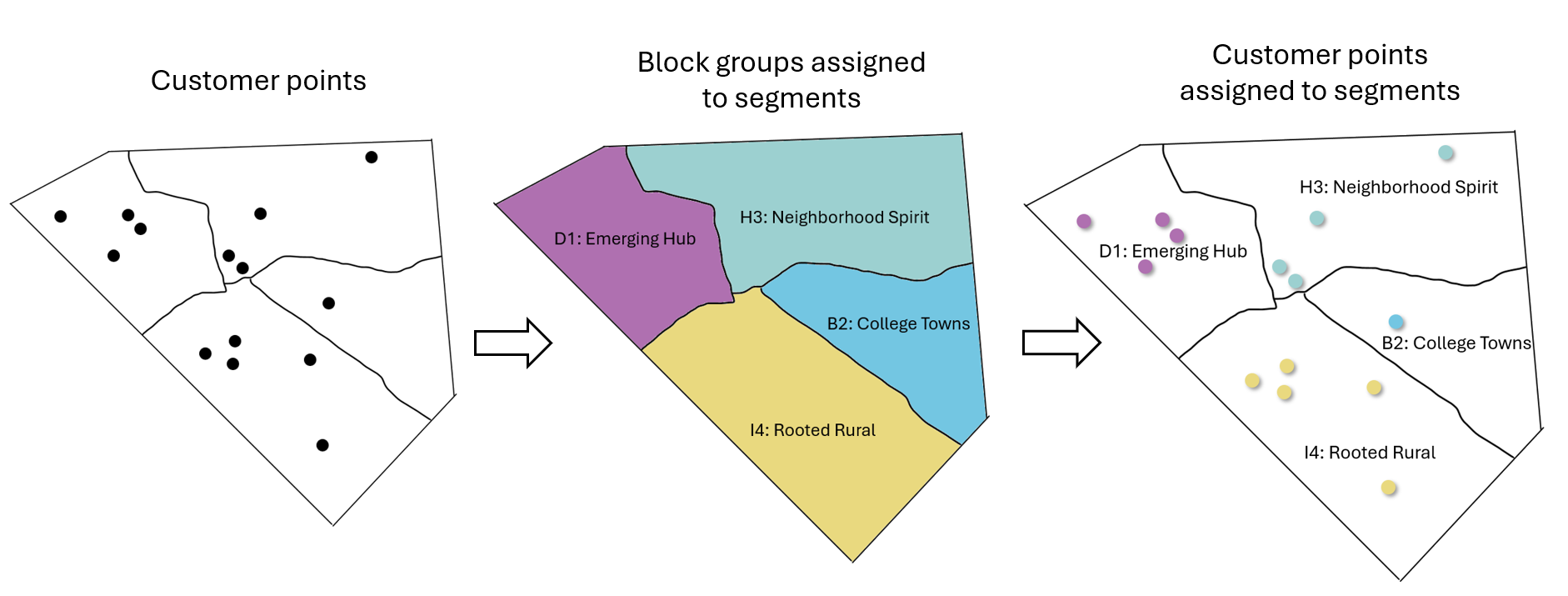

Customer profile calculations

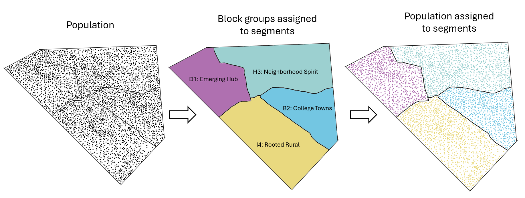

When you perform target marketing, you start by creating a customer profile that describes your existing customers using segmentation data. The customer profile can be based on either customer location point data or survey data that uses points. Each point is assigned a segment based on the census block group it is located in.
Diagram showing customer profile creation
Population assigned to segments based on the predominant segment in the block group.
In this example, there are 14 total customer points. Using the count of points assigned to each predominant ArcGIS Tapestry segment, the customer profile would look like this:
Segment ID Segment Name Count Percent
D1 Emerging Hub 4 4 / 14 = 28.57%
H3 Neighborhood Spirit 4 4 / 14 = 28.57%
I4 Rooted Rural 5 5 / 14 = 35.71%
B2 College Towns 1 1 / 14 = 7.14%

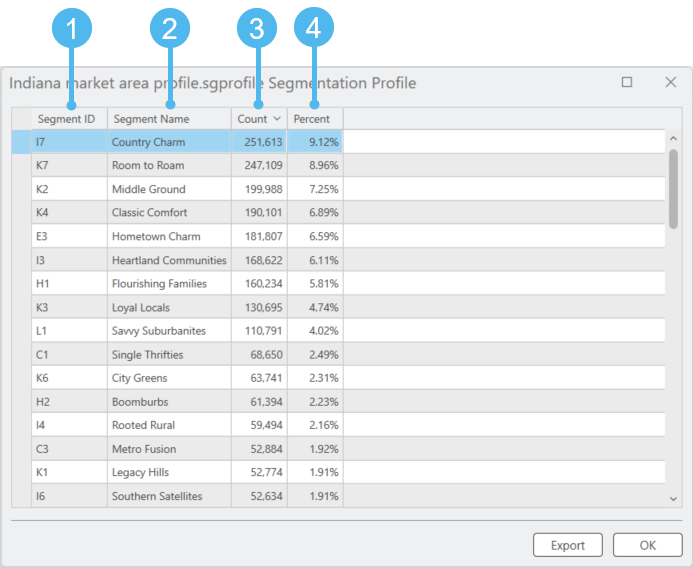

Market area profile catalog item
Market area profiles are stored as items in the Target Marketing subfolder of the Business Analyst node in the Catalog pane. You can also open the market area profile using the Market Area Profile button on the four-quadrant analysis chart.
Market area profile with call-outs
3 Count The total number of adults or households (depending on what you selected as your segmentation base during customer profile creation) in the market area living in block groups in which this segment is the predominant segment.
4 Percent The percentage of adults or households (depending on what you selected as your segmentation base during customer profile creation) in the market area living in block groups in which this segment is the predominant segment.

After creating or adding a customer profile, you create a market area profile that describes the demographics of the area you are analyzing. The market area profile provides a segmentation overview of the map extent (or other chosen market area), which will be used for comparison with your customers. The market area profile is based on the adult or household population (depending on what you selected as your segmentation base during customer profile creation) of the block groups in the market area you define. The adult or household population of each block group is assigned a segment based on its census block group.
Diagram showing market area profile creation
In this example, the block groups in the market area have a total population of 50,000. Using the count of the population assigned to each predominant ArcGIS Tapestry segment, the market area profile would look like this:
D1 Emerging Hub 13,527 13,527 / 50,000 = 27.05%
H3 Neighborhood Spirit 16,422 16,422 / 50,000 = 32.84%
I4 Rooted Rural 14,924 14,924 / 50,000 = 29.84%
B2 College Towns 5,127 5,127 / 50,000 = 10.25%

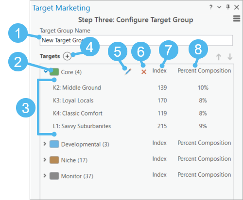

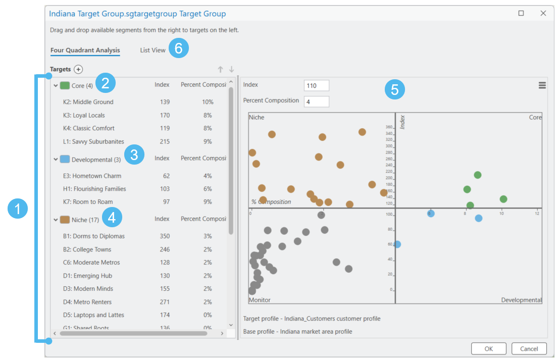

Target group
Target groups are created with the Create Target Group tool. This tool can be accessed within the Target Marketing workflow or through the Target Marketing toolset.
Target group in workflow pane
When accessed through the third pane of the workflow, target group configuration appears as follows:
Target group in wizard
1 Target Group Name field Enter a name for this target group. This name will appear in the Catalog pane when the analysis is complete.
2 Target A group of segments in this analysis. Groups are most often created to identify and organize similar-scoring segments. The default targets are Core, Developmental, Niche, and Monitor.
3 Segments The segments included in this target.
4 Add button Add a new target to the target group.
5 Edit button Modify the name of the target.
6 Delete button Delete the target from the target group.
7 Index The rate at which you are drawing customers from this segment, compared to the overall percentage of this segment in the market area.
8 Percent Composition The percentage of your customers assigned to this segment based on their location.

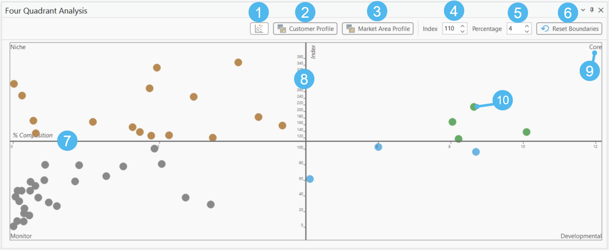

Four-quadrant analysis
The Four Quadrant Analysis pane displays segments as points on a four-quadrant chart, where the y-axis value represents the index of each segment and the x-axis value represents the percent composition of the segment.
Four-quadrant analysis in the workflow
The four-quadrant analysis can be accessed within the Target Marketing workflow or by opening the target group item from the Catalog pane.
Four-quadrant analysis with call-outs
1 Outliers button Turn outliers on or off in the analysis. See Outliers.
2 Customer Profile button Open the customer profile.
3 Market Area Profile button Open the market area profile.
4 Index field Change the Index value in the four-quadrant analysis.
5 Percentage field Change the Percentage value in the four-quadrant analysis.
6 Reset Boundaries Restore the index and percentage values to their defaults (110 and 4, respectively).
7 x-axis Represents the percent composition for segments in the analysis.
8 y-axis Represents the index for segments in the analysis.
9 Target Each quadrant represents a target in the analysis. The default targets are Core, Developmental, Niche, and Monitor.
10 Segment Each segment is plotted in a quadrant, according to its index value and percent composition.

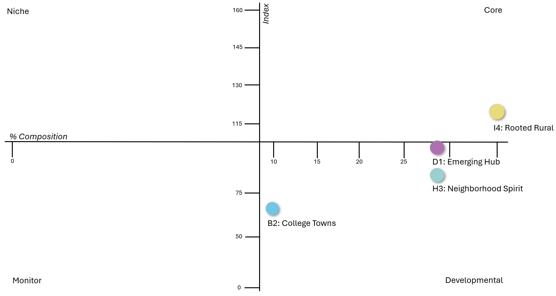

Four-quadrant analysis calculations
After creating a customer profile and a market area profile, the next step is to compare these profiles to determine who your “best” customers are. For each segment in your analysis area, the percentage of your customers is compared to the overall prevalence of this segment in the market area, using the following formula to create an index:
Index for segment = (Customer percentage/Market area percentage) * 100
In this example, the calculations would be as follows:
Segment ID Segment Name Index Percent Composition
D1 Emerging Hub (28.57 / 27.05) * 100 = 105.62 28.57
H3 Neighborhood Spirit (28.57 / 32.84) * 100 = 86.998 28.57
I4 Rooted Rural (35.71 / 29.84) * 100 = 119.67 35.71
B2 College Towns (7.14 / 10.25) * 100 = 69.66 7.14
Each segment is then plotted on a four-quadrant chart where the x-axis is the index value and the y-axis is the customer percentage. Note that the axes intersect at the default values: 110 for the index and 4 for the percentage:
Diagram showing four-quadrant analysis creation
Segments assigned to targets in four-quadrant analysis.

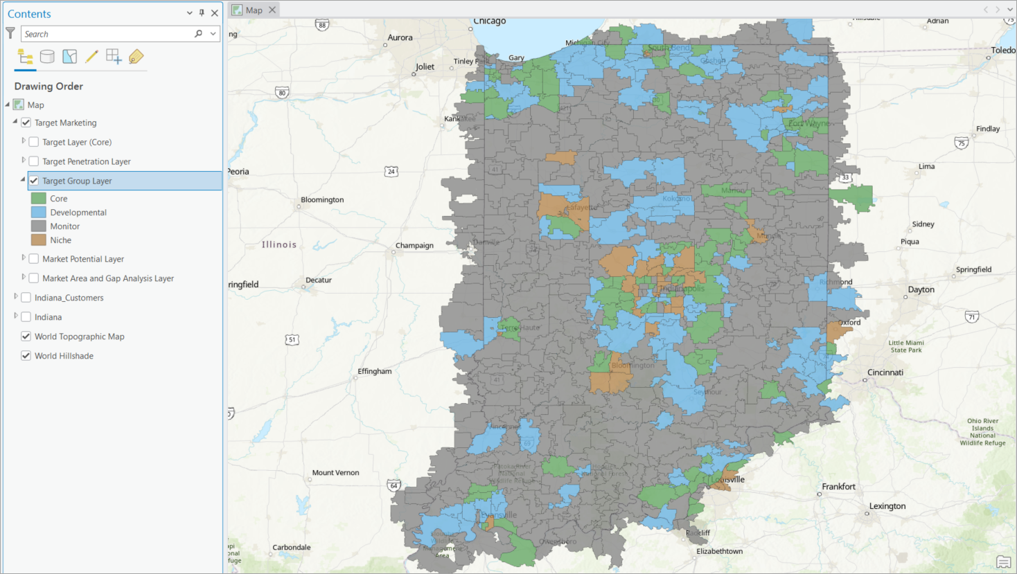

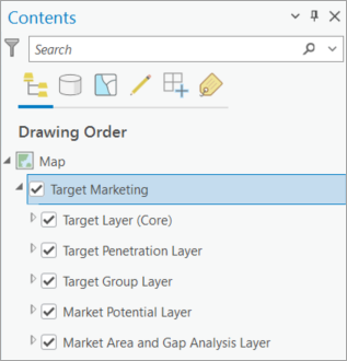

Map layers
The Target Marketing workflow creates up to five map layers that display information from the analysis.
Map layers in Contents pane
The workflow creates a Target Marketing group layer in the project's Contents pane, containing map layers you opted to create: target, target penetration, target group, market potential, and market area and gap analysis layers.
Target marketing group layer

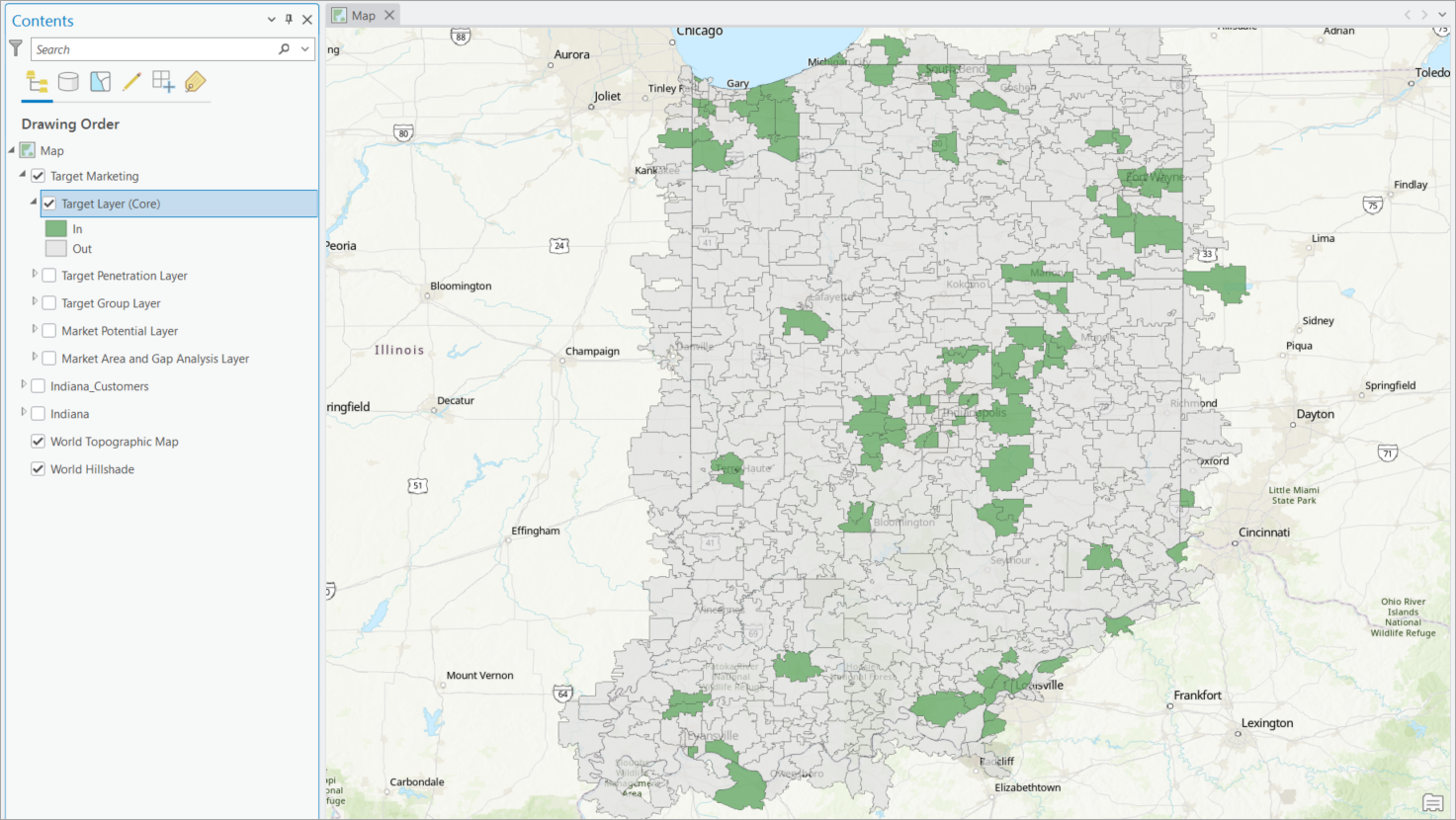

Target layer
Once you specify a target to map in this layer, the layer calculates whether each polygon in the market area is "in" or "out" of that target. For example, if a block group is "out" of the Core target, this means the block group's predominant segment is not one of the Core segments. The relevant calculations are as follows:
  • In—This polygon's predominant segment is one of the segments in the specified target, such as Core or Niche.
  • Out—This polygon's predominant segment is not one of the segments in the specified target.
Target layer on map
If run from the geoprocessing tool, an existing target or a selected set of segments may be used as the input.
Geoprocessing tool: Generate Target Layer

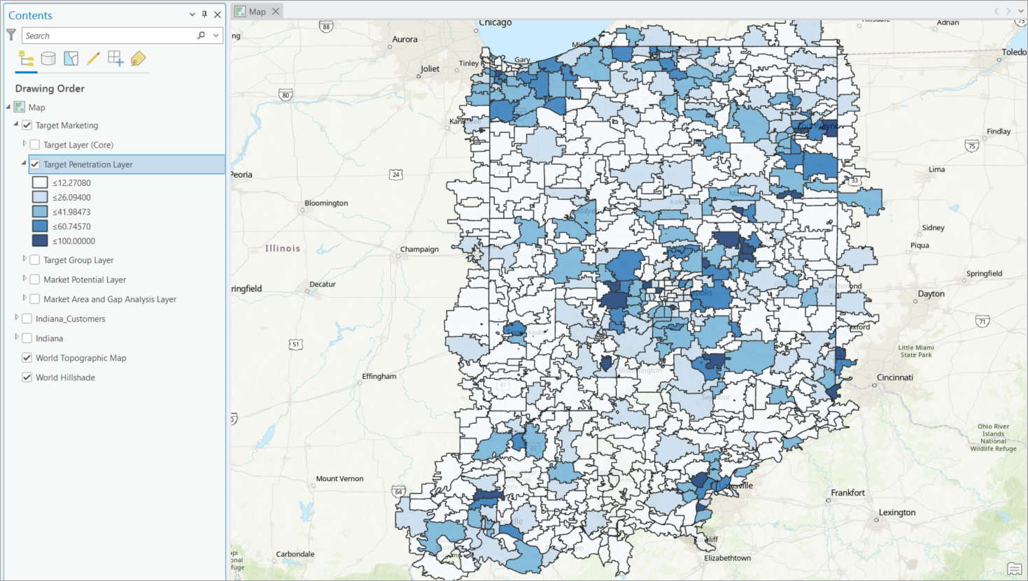

Target Penetration Layer
Once you specify a target to map in this layer, the layer uses a color-coded gradient to display how many households or people in each polygon fall into the selected target (such as Core or Developmental), relative to the number of households or people in that polygon in any segment. The relevant calculations are as follows:
  • Penetration is calculated by counting the number of households or people located in each polygon where the predominant segment is part of the target, and dividing the count by the total number of households or people in the polygon.

Target penetration layer on map
Sugerencia:
This map layer is most effective when created for a geography level higher than the base geography of the analysis. For example, ArcGIS Tapestry data is mapped at the block group level; use the Geography Level drop-down list to choose census tracts or ZIP codes for a more meaningful visualization.
If creating this type of output in the workflow, an existing target must be used as the input. If accessed from the geoprocessing tool, an existing target or custom set of segments can be used.
Geoprocessing tool: Generate Target Penetration Layer
Target Group Layer
This layer displays color-coded classes for each target in the target group. Polygons in the selected geography level receive a target's shading if the predominant segment is one of the segments in the target. Using the default target group from the workflow creates a layer with four thematically shaded classes: Core, Developmental, Niche, and Monitor.
Target group layer on map
Geoprocessing tool: Generate Target Group Layer
Market Potential Layer
This layer displays expected customers at a selected geography level. If your customer profile contains volume information—for example, dollars spent—expected volumes are also calculated.
Market potential layer on map
Geoprocessing tool: Analyze Market Potential

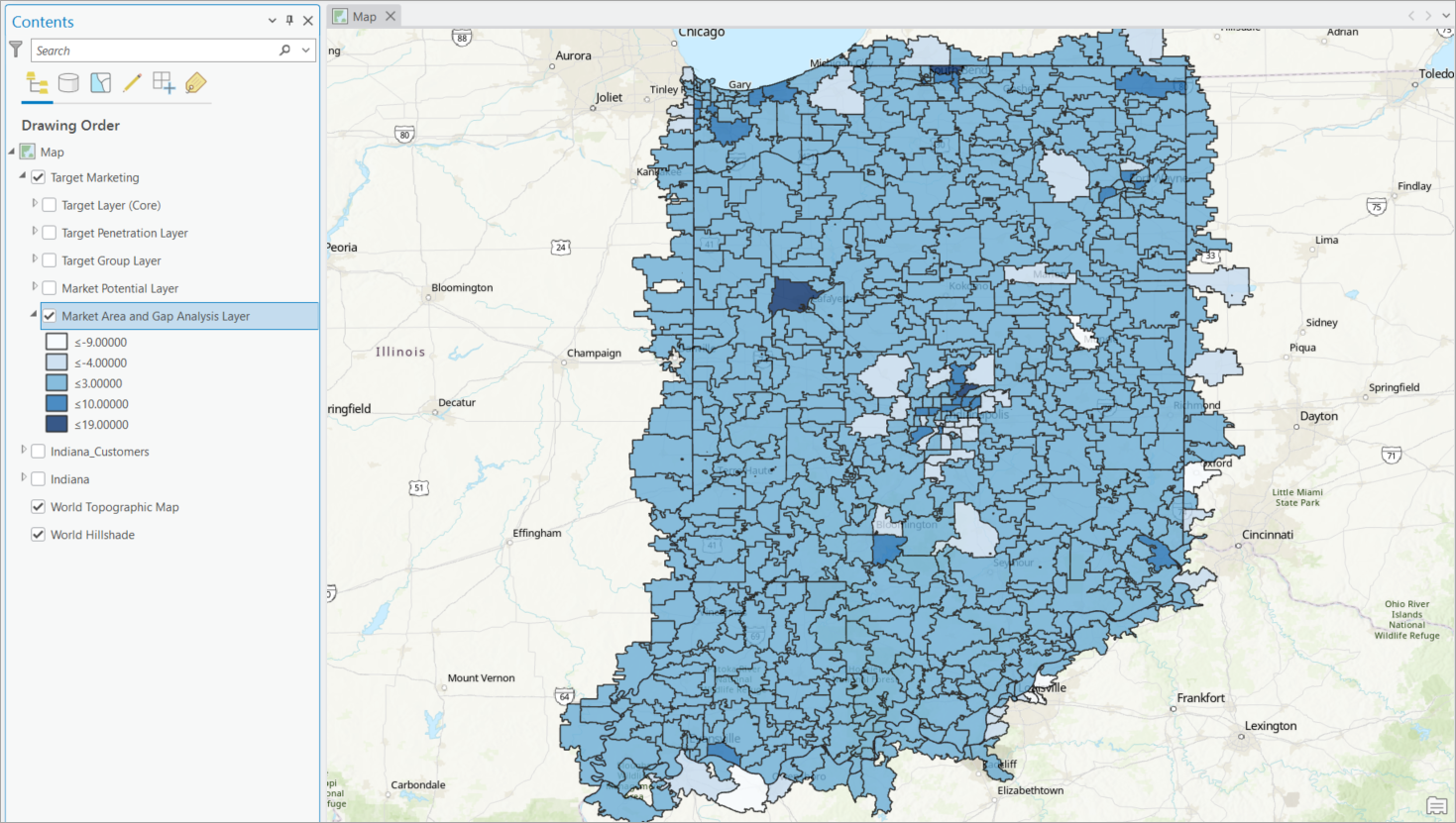

Market Area and Gap Analysis Layer
This layer displays the gap between expected customers and actual customers at a selected geography level. The layer shows where you are exceeding or falling short of expectations for market penetration. A target group that identifies your Core and Developmental targets is required for the market area and gap analysis layer.
Market area and gap analysis layer on map
Geoprocessing tool: Analyze Market Area Gap
