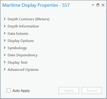

On the Maritime Chart Service tab, in the Maritime Chart Service group, click Display Properties.
Sugerencia:
The Explore tool is also on the Maritime Chart Service tab. Use this tool to identify features in a Maritime Chart Service layer.
The Maritime Display Properties pane appears with the title of the selected layer.

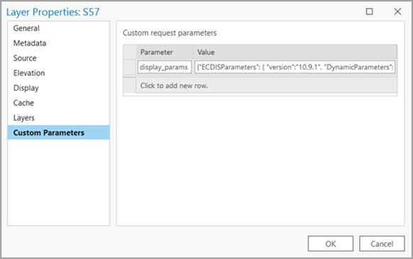

The Maritime Display Properties pane first populates using the selected Maritime Chart Service layer's default values from the service. These default values are stored in the Custom Parameters settings in the Layer Properties pane and are used the next time the Maritime Display Properties pane is accessed.
Do one of the following to edit the display properties:
Change one or more properties, and click Apply.
Check the Auto Apply check box to automatically send a new request to the map service for each change.

Each change applied to the display properties of a maritime layer is stored in the Custom Parameters settings in the Layer Properties pane. These settings are saved with the project and used to populate the Maritime Display Properties pane when the project is opened again.
