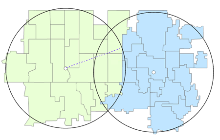

  • The Maximum Territory Radius parameter value specifies the maximum size of the territory. Adjacent territories can be smaller than the radius specified if the boundaries between territories overlap. Territories will expand until the radius value is reached.
    Maximum Territory Radius parameter example

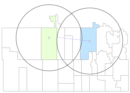

  • When setting the Minimum Distance Between Centers parameter, the distance between centers can be greater than the minimum distance.
    Minimum Distance Between Centers parameter example
