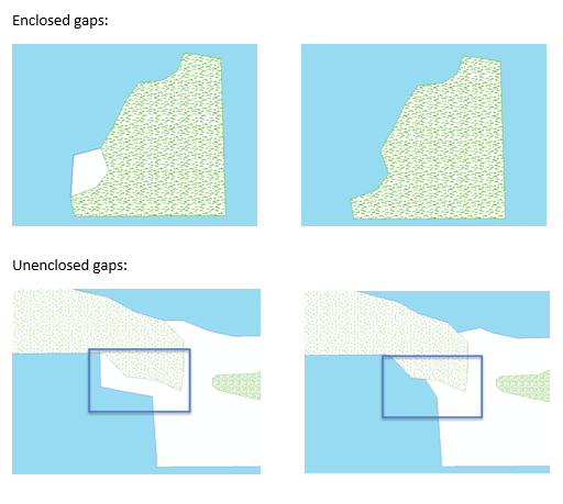

Many types of polygon features should have coincident boundaries with other features. Coincident boundaries can be important for features in a single polygon feature class, such as parcels, or between features in different feature classes, such as lakes and surrounding vegetation. A gap between the features exists when there is space between the boundaries of two or more features.
Ilustración
Fill Gaps tool illustration

  • Unenclosed gaps exist when two polygon boundaries are within a specified distance of each other. The two polygon features do not have to touch each other at any point.
  • When the Fill Unenclosed Gaps parameter is checked, the unenclosed gaps are filled first. Enclosed gaps are filled after unenclosed gaps are filled.
  • Enclosed gaps exist when there are gaps between two polygon boundaries.
