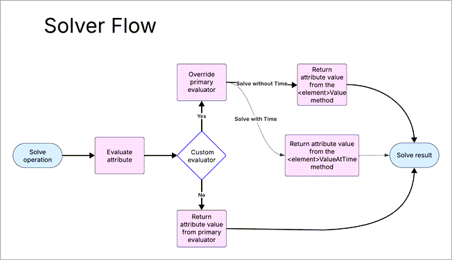

The following value methods can be implemented: edgeValue, edgeValueAtTime, junctionValue, junctionValueAtTime, turnValue, and turnValueAtTime. Methods prefixed with edge affect the attribute values for edge sources, methods prefixed with junction affect the attribute values for junction sources, and methods prefixed with turn affect the attribute values for turn sources. Methods with the AtTime suffix are invoked during time-enabled solve operations, and methods without that suffix are invoked when time is not being used.
In general, during a solve operation when an attribute is evaluated and there is an attached custom evaluator, it will override the primary evaluator. The value returned from the related element method (for example, edgeValue) will be used by the solver engine in the remainder of the analysis. Using these value methods, you can implement the custom logic to set the final value for an element’s attribute.
The ValueAtTime methods provide a datetime parameter, which is the date and time the element will be encountered along a potential route. These methods are called for each element, potentially multiple times, during a solve operation. Any code in these methods should be performant.
You must implement at least one of these value methods.
