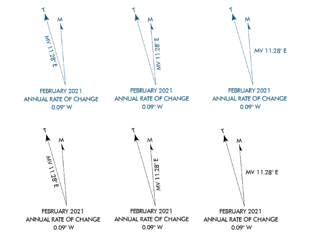

Edit the aviation north arrow
Disponible avec une licence Aviation Charting.
ArcGIS Aviation Charting allows you to create a configurable north arrow for your aeronautical charts. The aviation north arrow contains symbology and labels that are commonly used on aeronautical charts. The components of an aviation north arrow include the following:
  • True north arrow (T)—The north arrow angle points to geodetic north (to the north pole) as calculated by the coordinate system of the associated map frame, at the center of the map.
  • Magnetic north arrow (M)—The north arrow angle points to the north magnetic pole, as indicated by the north-seeking needle of a magnetic instrument.
  • Grid north arrow—The north arrow angle points to the top of the chart.
Remarque :
You can change the direction of the grid north arrow by rotating the connected map frame.
Learn more about generic north arrows in ArcGIS Pro
Aviation north arrow gallery

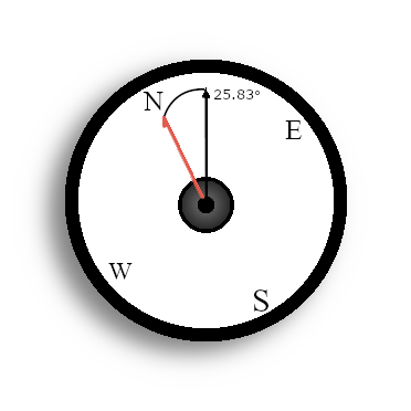

Magnetic variance
Magnetic variance refers to the angular distance between magnetic north and true north. A compass or other navigational equipment that relies on magnetic north must be calibrated to specify which direction is true north. Since magnetic variance changes over time and depending on the latitude and longitude, it is crucial that aeronautical charts show the correct magnetic variance to allow for the safe travel of aircraft.
A compass calibrated using magnetic variance
