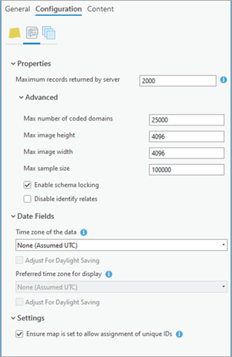

  10. Click the Configuration tab.
  11. Ensure that the Configure Layers tab is active.
  12. In the Capabilities section, check the Topographic Production check box to enable the service.

  4. Optionally, click Configure Parameters to configure more properties.
    Configuration tab in the Share As Web Layer pane
